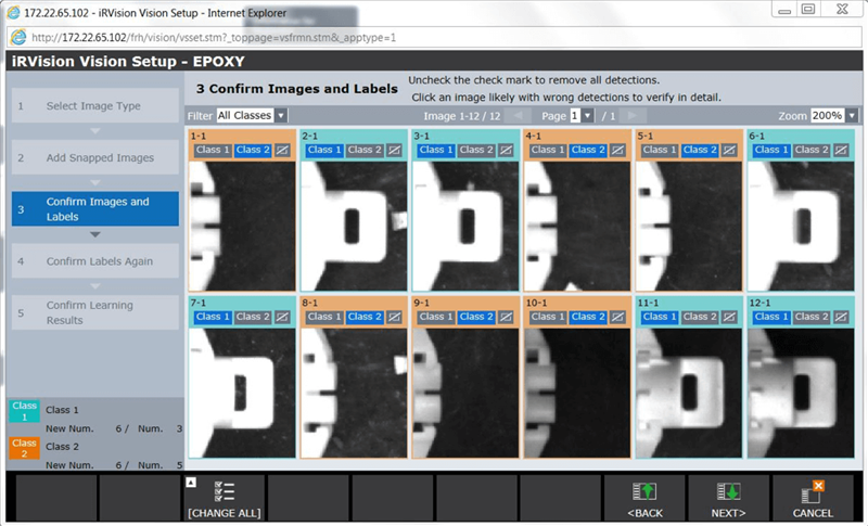

Figure 2 shows an example where the operator differentiates between examples.  The operator classifies a plastic applicator with a lid as class 1 and without a lid as class 2.  All class 1 examples are cyan and class 2 examples are orange.
Ai error proofing2 1
Figure 2 Classification

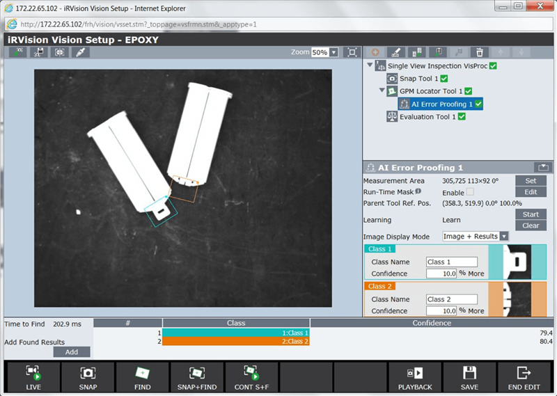

Figure 3 shows the results of the classifications from Figure 2.  Multiple objects may be classified in the same image.  Figure 3’s example shows two different applicators.  The one with a lid is highlighted in cyan and the one without a lid is highlighted in orange.  In this case, iRVision’s GPM Locator Tool identified the location and orientation of the applicator.  Combining the GPM Locator Tool’s pattern matching ability with the AI Error Proofing Tool allows parts to be found and classified at the same time in the same image.  The combination of these tools allows the robot to pick plastic applicators from a conveyor and place the ones with a lid into the filling machine, and the ones without into a reject bin.
Ai error proofing3 1
Figure 3 Found Results
