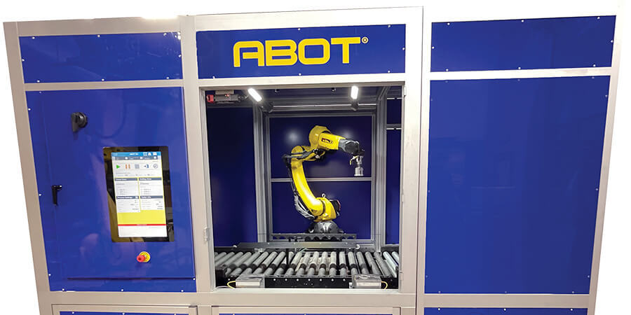

Much of the technology for automated decant was already developed and in Robotica’s IP portfolio.  Many of their box opening technologies have earned domestic and international patents that support the evolution of automated decant from automated box opening, including  ABOT® which is a key component in automating decant.  Now, ABOT M1 is available with state-of-the-art FANUC industrial robots, metrology and the AI capabilities to support decanting of products into totes.  ABOT M1’s computational and sensing power makes it the industry’s next-generation intelligent platform for automated decant processes, providing easy integration with goods-to-person AMR systems and other automated processes or work cells.

Robotica’s industry leading second-generation ABOTm-1 for automated decant is a natural progression following years of experience designing and producing multiple commercialized automated box opening technologies.  Now, the ABOTm-1 uses data elements to successfully open boxes without damaging the inner pack contents.  Generation one systems required an operator to input data for various packages, and used a manual database to maintain the information.  However, it quickly became clear that a manual database would not be effective for many eCommerce warehouses that process tens of thousands of SKUs with constantly changing packages and shipping cartons.  Plus, in today’s fast-moving distribution culture, maintaining a manual database with this magnitude is far too labor intensive and time consuming.
The ABOT Generation II uses autonomous learning of box dimensions and cutting metrics. This method provides effective data management, and the ability to accurately open an ever-expanding range of box sizes and configurations while protecting the inner packs.  The AI module allows for continuous learning and improvement that can be shared across multiple ABOTm-1 machines in a network.

The combination of ABOTm-1 box opening with decant and a FANUC robot into ePack technology is offered in two standard modular production models for quick delivery and installation.  ABOT+ ePack systems are easily configured and integrated into micro-fulfillment and large DC applications. For example, a single ePack-Micro processes up to 400 shipping cases per hour, and a single ePack-DC handles up to 800 cases per hour.  Higher volumes are achieved using multiple cells, and options include automated receiving, de-palletizing, dimensioning, weighing and scanning.
