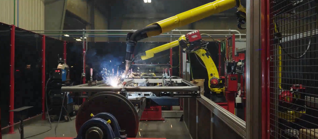

Two yellow FANUC welding robots performing arc welding on a metal frame fixture within a red-fenced industrial work cell, with sparks flying from the weld point.
Facing a workforce shortage and struggling to meet demand, livestock and equine product manufacturer Hutchison Inc. turned to automation to address a particularly difficult welding production line for their steel gate products.
To ensure that they had access to on-site support before, during and after the delivery process, first-time robotics user Hutchison Inc. relied on Colewell Automation in central Iowa to develop a solution that could match the high-quality work of their skilled welders.
To minimize lead time and get the system up and running as quickly as possible, Colewell Automation used simulation software to design a dual-sided cell with two FANUC robots and Lincoln welding equipment. With an STT option in the center that alternates between fixtures on either side, the robots are able to work on one side while a two-person welding team unloads and reloads the other side of the system. By using simulation software to design the cell, both the build time and installation process was shortened, resulting in as little downtime as possible.
With the automated system in place, Hutchison Inc. has increased gate production from 8-10 per hour to 11-13 per hour, an hourly increase of at least 37 percent. In addition to this, finished products feature more consistent welds and higher quality overall, with far fewer defects. According to Breanna Anderson, robotic welding team leader, the team is enjoying not only the process, but “using problem solving skills and welding skills to get things moving and grooving again.”
