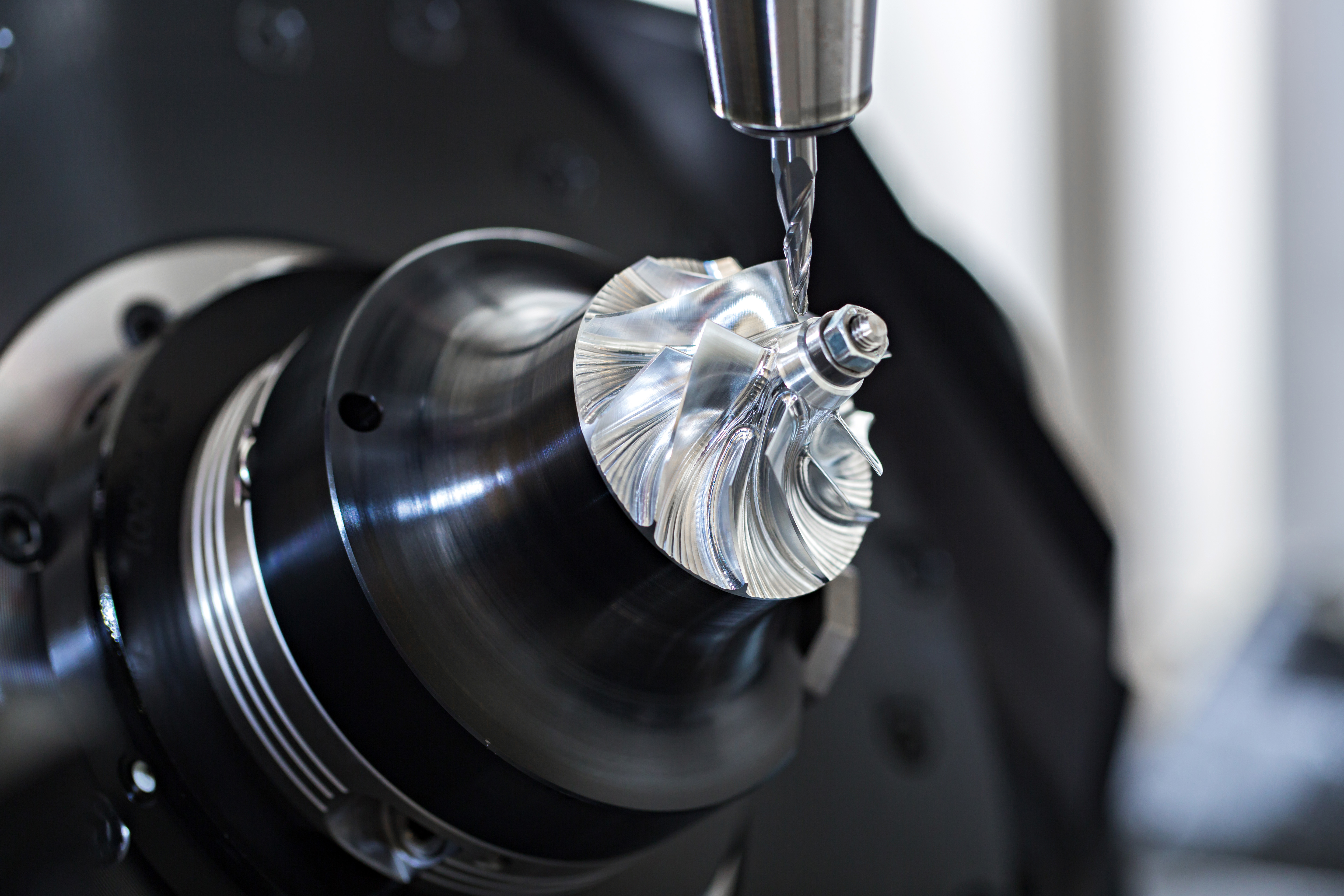

Many job shops often need help justifying the move to 5-axis. A single 5-axis machine with the latest FANUC CNC technology can typically do the same work with significantly shorter manufacturing times than multiple 3 axis machines. The freedom of motion allows entire parts to be cut without manually re-fixturing the part resulting in significant reduction in overall part manufacturing time. The freedom of motion also allows greater part complexity, making it possible to bid on higher profit work. Due to shorter tools and better tool orientations for the required cut, higher feed rates are often possible further reducing cycle times and part quality. Overall accuracy is improved as well due to the advanced algorithms and the reduced likelihood of manual error. FANUC has the advanced CNC functionality, expertise, and tools to help you start taking advantage of this more efficient machining process.

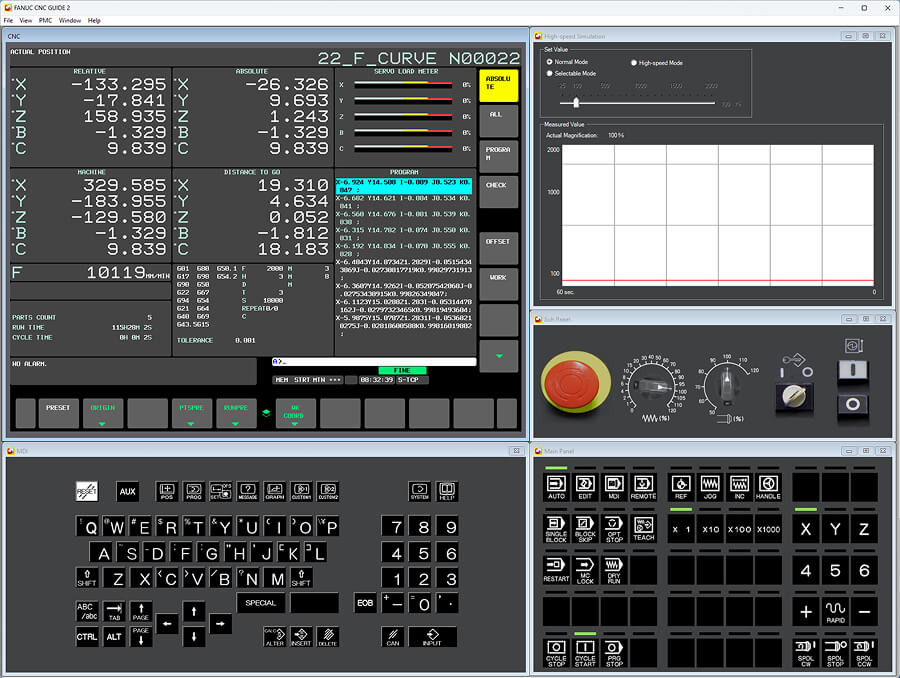

Do your people have the right skills to run advanced machinery? FANUC’s CNC Machining Simulation for Workforce Development now includes 5-axis training to develop the workforce you need.
