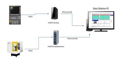

FANUC MTConnect Server can be installed on an industrial PC, embedded PC or other PC at the machine tool. Windows 7 and 10 are the primary operating systems that are currently supported. The FANUC MTConnect Server package consists of the FANUC MTConnect Adapter and a standard MTConnect agent, however it can be connected to an existing MTConnect adapter if one is available. Configuration can be completed quickly and easily using the simple Windows UI.
Communication Flow
Data is sent from the FANUC CNC to the PC where the FASMTC software is installed using the FANUC FOCAS protocol over a standard Ethernet connection.  FASMTC converts the data to the structured MTConnect XML and is sent to the data collection PC or any other MTConnect client application.
FASMTC Dataflow
