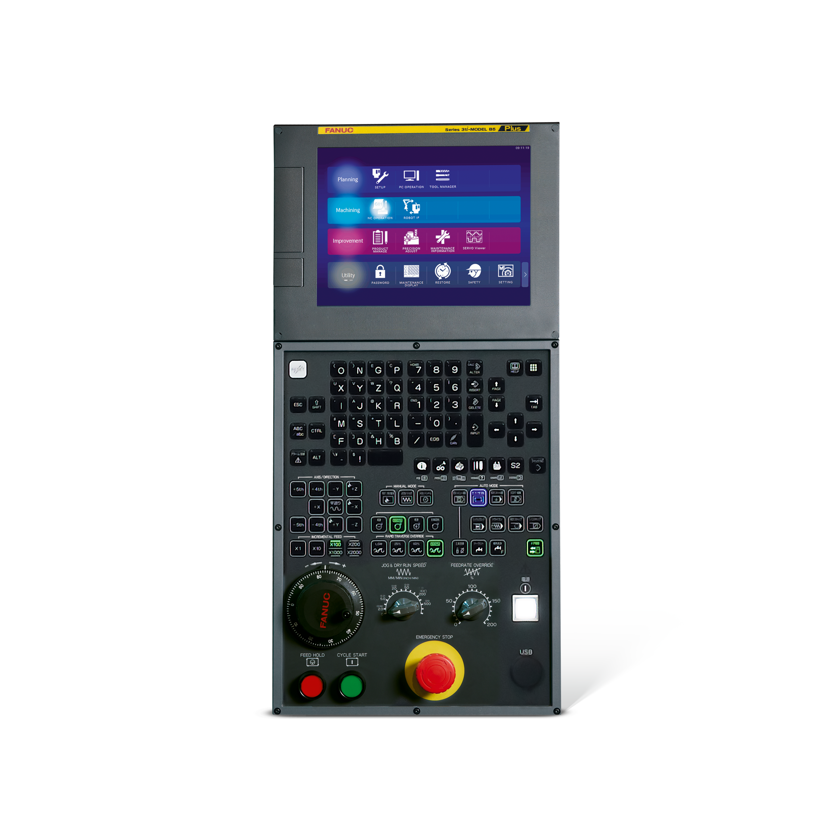

Compatible Controllers
FANUC Series 31i MODELB5 Plus ROBODRILL
Controllers
ROBODRILL 31iMB5 Plus
The FANUC ROBODRILL 31i‑B5 Plus control delivers faster cycles, higher uptime, and automation‑ready performance backed by proven FANUC reliability.
View ROBODRILL 31iMB5 Plus

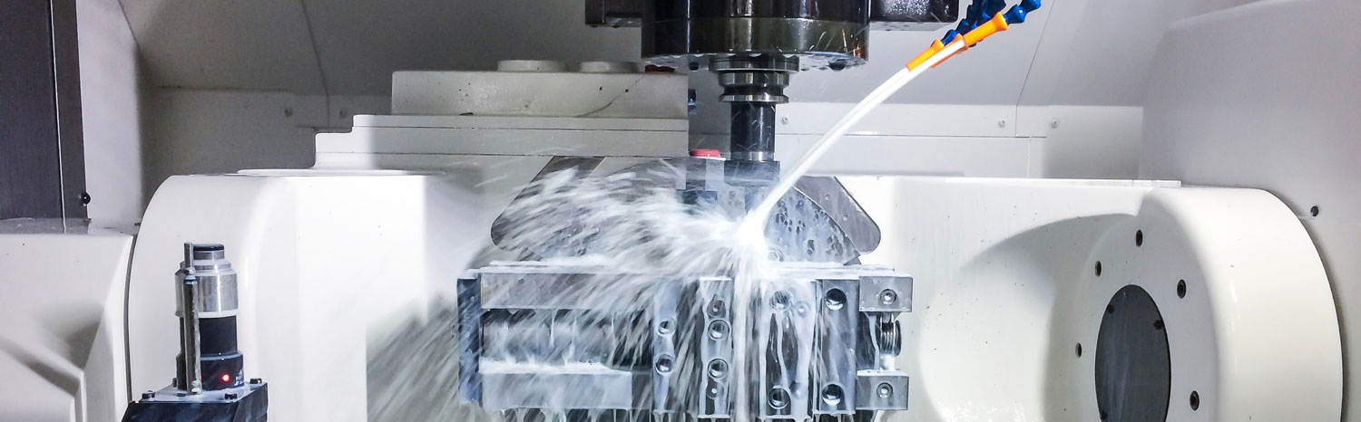

Milling
5 axis machining3
5-Axis
