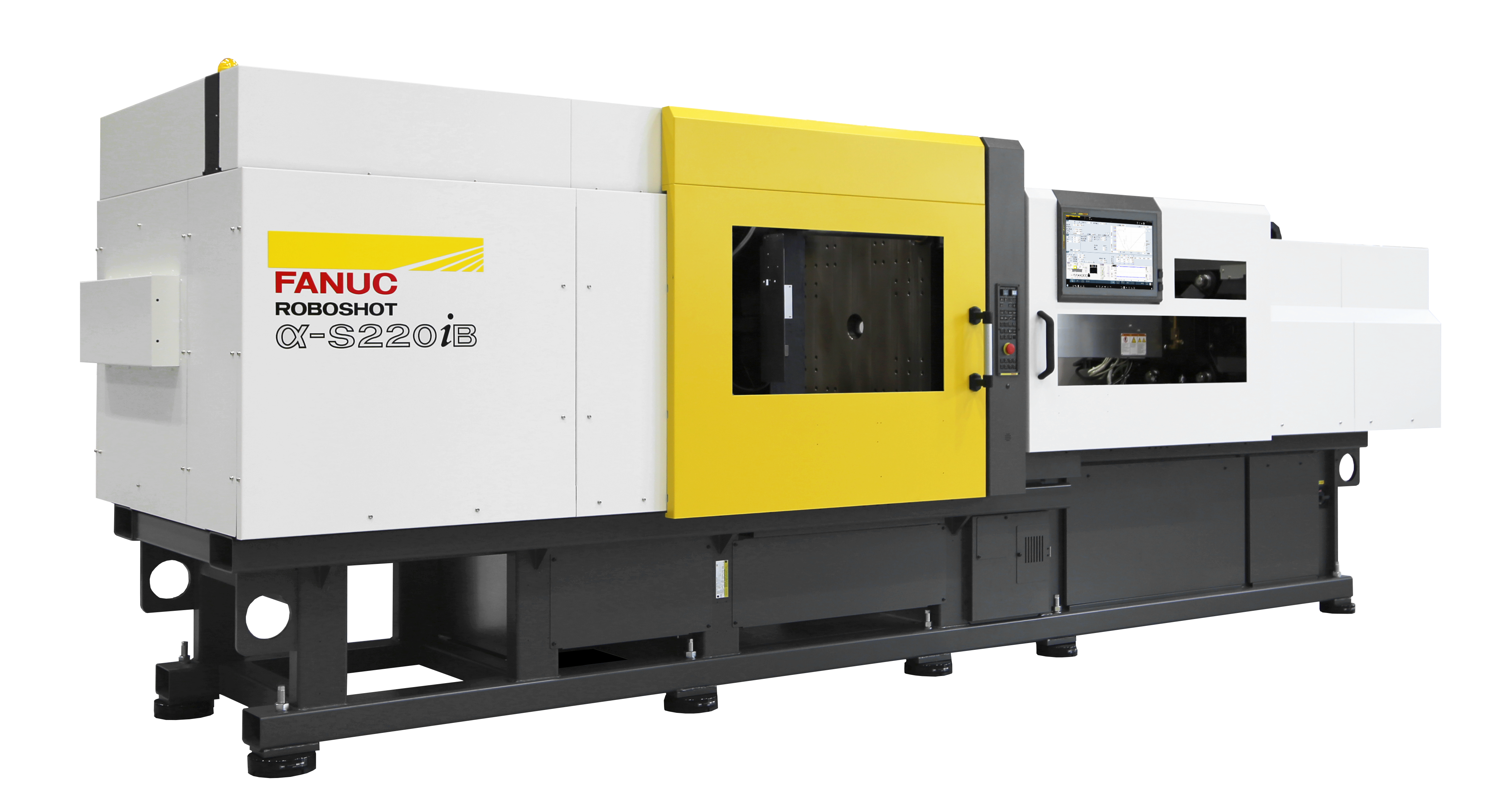

ROBOSHOT α-S220iB
Tonnage
2200 kN | 220 tonf
Screw Diameter
32, 36, 40, 44, 48, 52, 56 mm
Tie Bar Spacing (H × V)
650x650 mm
Clamping Mechanism
5 Point double toggle
Tonnage
2200 | 220 tonf
Max/Min Die Height (Single Platen)
650-250 mm
Max/Min Die Height (Single Platen, Increased)
750-250 mm
Clamping Stroke
550 mm
Locating Ring Diameter
160 mm
650x650 mm
Platen Size (H × V)
900x900 mm
Minimum Mould Size (H × V)
375x375 mm
Maximum Mould Weight (Single Platen)
1500-1500 kg
Ejector Stroke
150 mm
Maximum Ejector Force
35|3.5 tonf
Maximum Ejector Force (Increased)
80|8.0 tonf
Screw Diameter
32,36,40,44,48,52,56 mm
Injection Stroke
150,150,150,176,176,208,208 mm
Max. Injection Volume
121,153,188,268,318,442,512 cm³
Nozzle Touch Force
30|3.0 tonf
Nozzle Touch Force (Increased)
50|5.0 tonf
