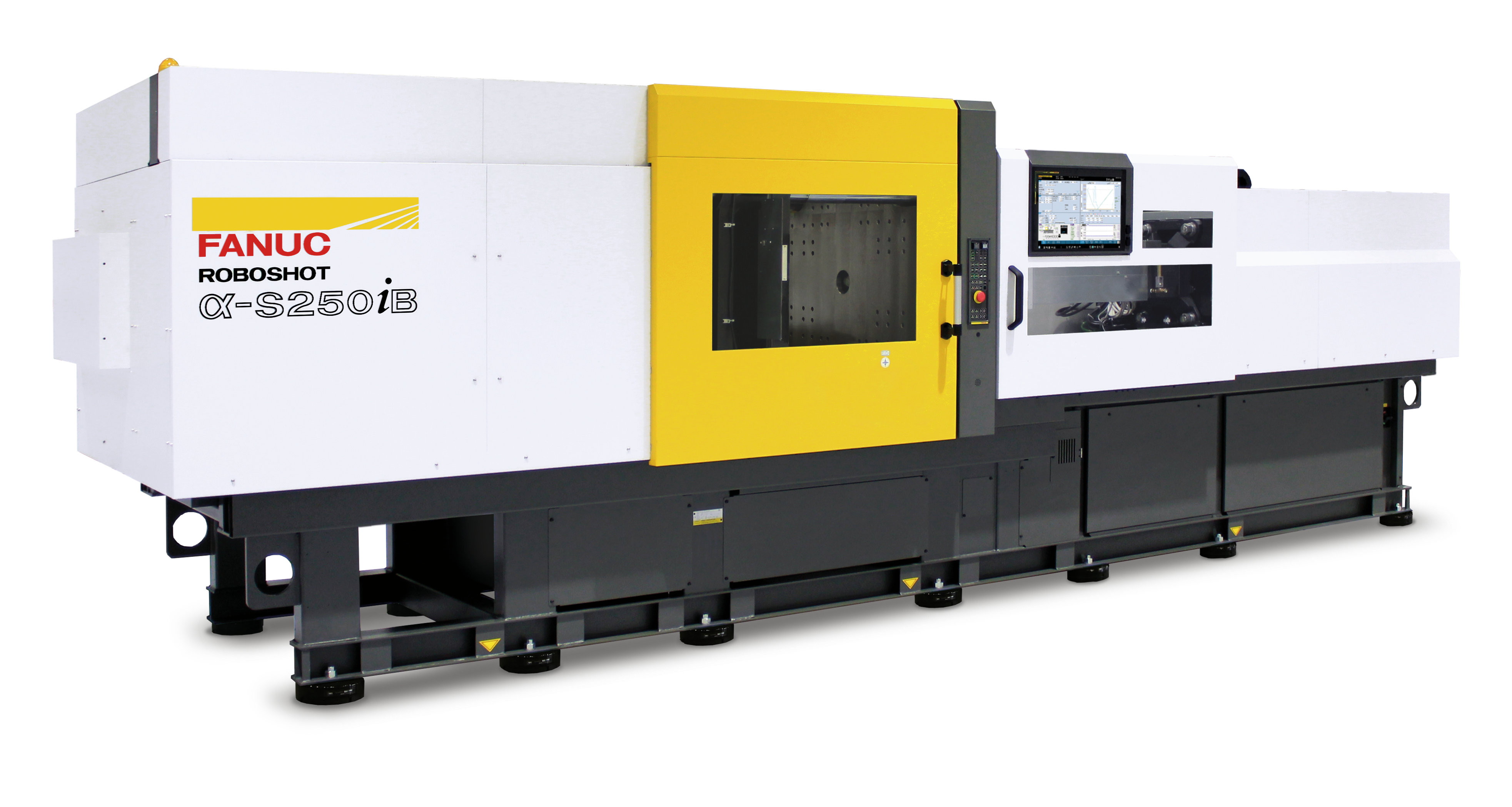

ROBOSHOT α-S250iB
Tonnage
2500 kN | 250 tonf
Screw Diameter
32, 36, 40, 44, 48, 52, 56 mm
Tie Bar Spacing (H × V)
710 x 635 mm
- Clamping Mechanism
- Double toggle
- Tonnage
- 2500 | 250 tonf
- Tonnage (Increased)
- 3000 | 300 tonf
- Max/Min Die Height (Single Platen)
- 650-300 mm
- Max/Min Die Height (Single Platen, Increased)
- 750-300 mm
- Clamping Stroke
- 600 mm
- Locating Ring Diameter
- 160 mm
- Tie Bar Spacing (H × V)
- 710 x 635 mm
- Platen Size (H × V)
- 1030 x 960 mm
- Minimum Mould Size (H × V)
- 420 x 385 mm
- Maximum Mould Weight (Single Platen)
- 2000-2000 kg
- Ejector Stroke
- 200 mm
- Maximum Ejector Force
- 80 | 8.0 tonf
- Screw Diameter
- 32,36,40,44,48,52,56 mm
- Injection Stroke
- 150,150,150,176,176,208,260 mm
- Max. Injection Volume
- 121,153,188,268,318,442,640 cm³
- Nozzle Touch Force
- 30|3.0 tonf
- Nozzle Touch Force (Increased)
- 50|5.0 tonf
