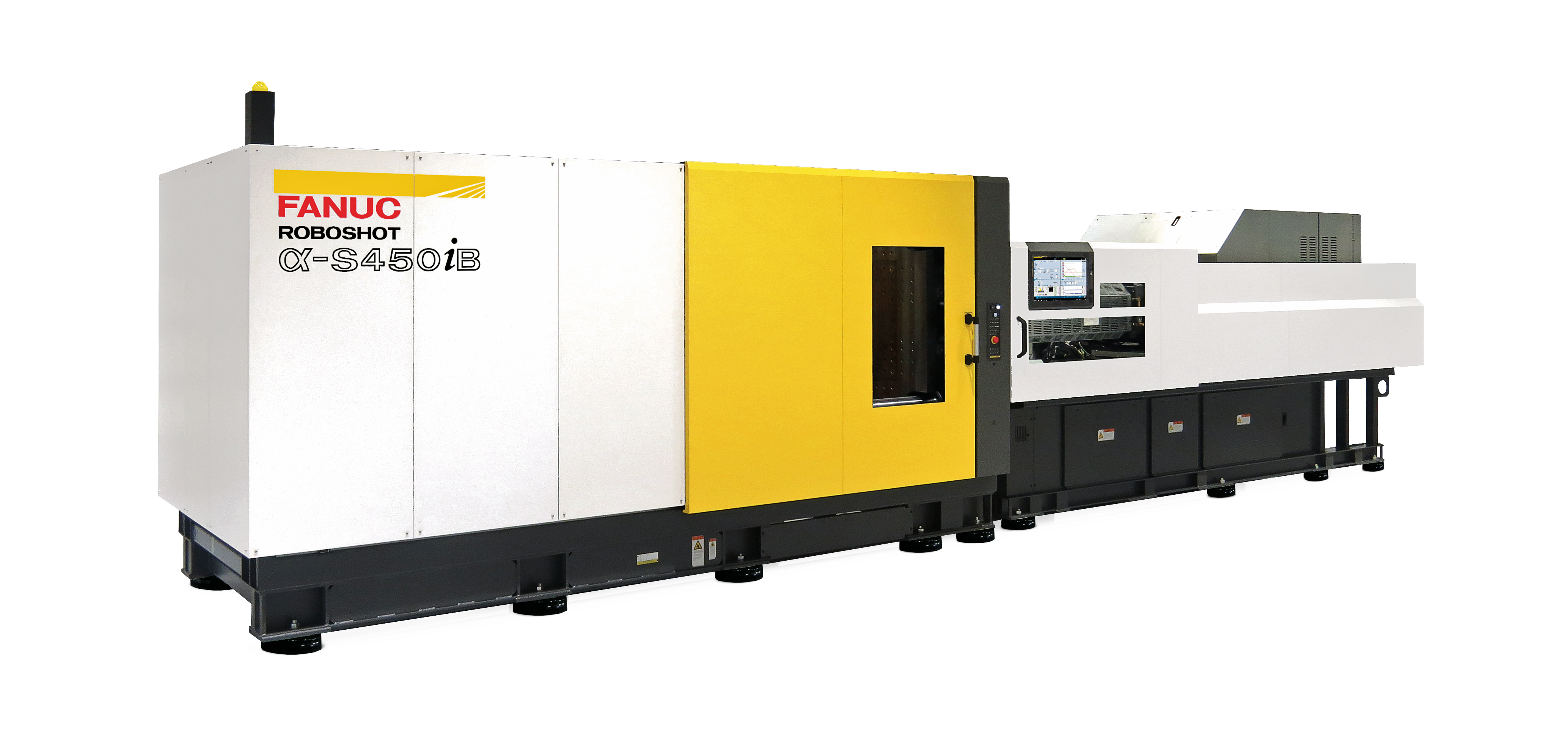

ROBOSHOT α-S450iB Small Capacity
Tonnage
4500 kN | 450 tonf
Screw Diameter
48, 52, 56, 64, 68, 72 mm
Tie Bar Spacing (H × V)
920 x 920 mm
- Clamping Mechanism
- Double toggle
- Tonnage
- 4500 | 450 tonf
- Tonnage (Increased)
- 5000 | 500 tonf
- Max/Min Die Height (Single Platen)
- 1000-350 mm
- Clamping Stroke
- 900 mm
- Locating Ring Diameter
- 200 mm
- Tie Bar Spacing (H × V)
- 920 x 920 mm
- Platen Size (H × V)
- 1300 x 1300 mm
- Minimum Mould Size (H × V)
- 535 x 535 mm
- Maximum Mould Weight (Single Platen)
- 4500-4500 kg
- Ejector Stroke
- 250 mm
- Maximum Ejector Force
- 150 | 15.0 tonf
- Screw Diameter
- 48,52,56,64,68,72 mm
- Injection Stroke
- 176,208,260,260,260,260 mm
- Max. Injection Volume
- 318,442,640,836,944,1059 cm³
- Nozzle Touch Force
- 30|3.0 tonf
- Nozzle Touch Force (Increased)
- 50|5.0 tonf
