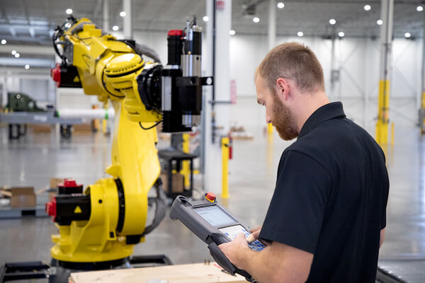

Fanuc employee programming m 810

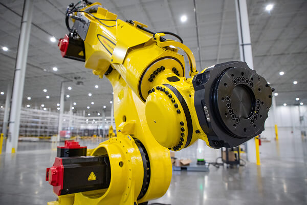

Fanuc m 810 closeup
Precision Under Load
Both models deliver high absolute positional accuracy and repeatability suited for advanced machining environments. The M-810/190-20B offers ±0.02 mm repeatability with a 190 kg payload, while the M-810/270-27B provides 0.03 mm repeatability with a 270 kg payload—ensuring stable, accurate performance when handling large tools or heavy machining heads.

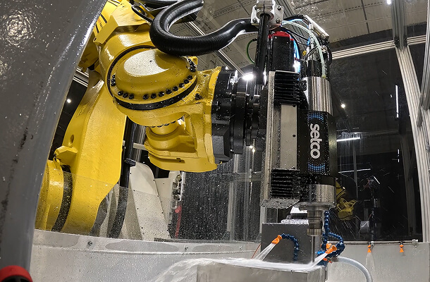

M 810 wet machining
Industrial-Grade Environmental Protection
Suitable for both dry and wet machining operations, the M-810 series is rated for IP67 protection at the J3 arm and wrist. This allows the robots to reliably operate in harsh manufacturing conditions where there frequent exposure to cutting fluid, metal chips, and machining debris.
