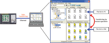

Program Transfer Tool is a PC-based productivity software tool that provides a simplified graphical interface for “drag and drop” of files between a PC and a CNC control. Large part program files can be input/output directly to data server storage. It enables users to take advantage of Embedded Ethernet for program transfer without having to set up their own PC based FTP application.

With the Program Transfer Tool, users can define communications between a PC and up to 255 FANUC CNC controls. The built-in Setting Dialog application aids in setup and initial communication testing. Each machine setting automatically opens the PC folder when communication is started, so that the user does not have to hunt for the proper PC storage location, which ensures the proper part program files are used. In addition to part programs, the transfer of tool offset and macro variable tables is also supported. This file transfer software tool provides a simple and cost-effective way for CNC programmers to transfer files seamlessly between CNC and PC, and it offers a fast, easy way to perform CNC program housekeeping and data backups.
