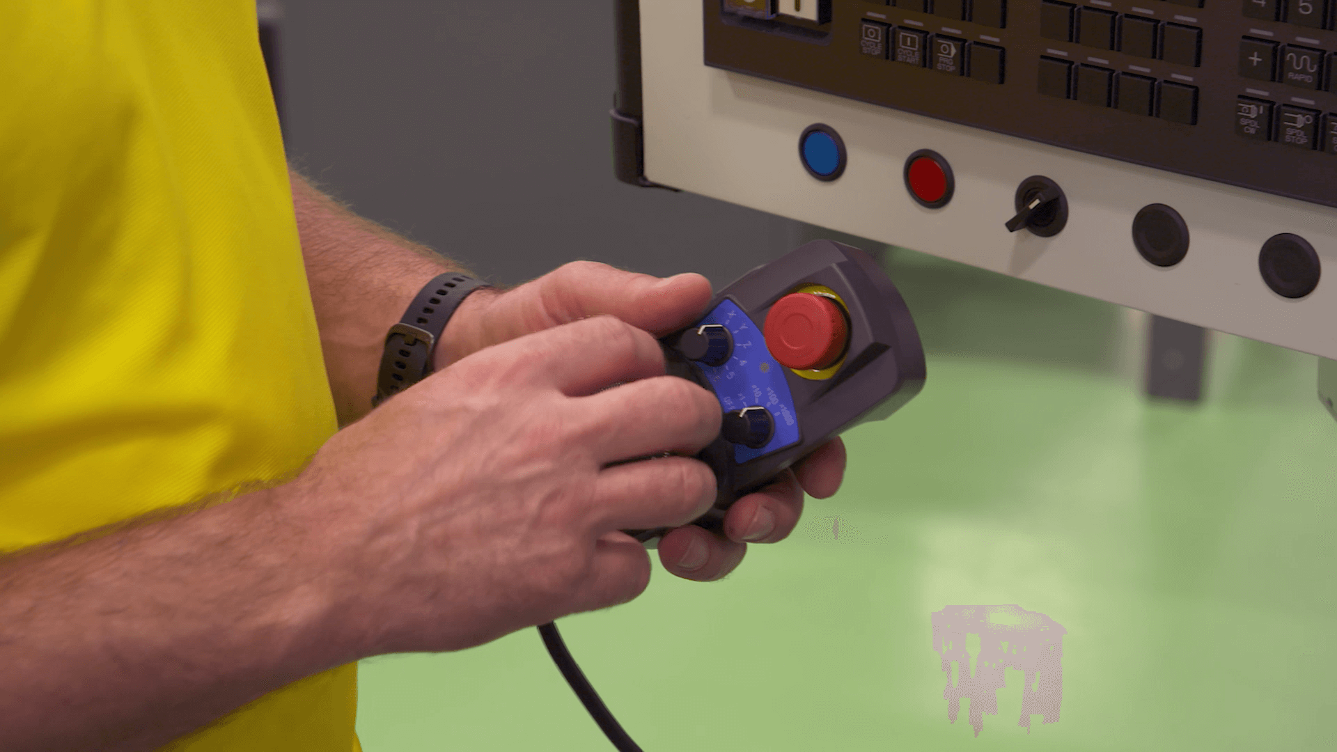

  • Additional option available for robot jogging control from machine Manual Pulse Generator (MPG)

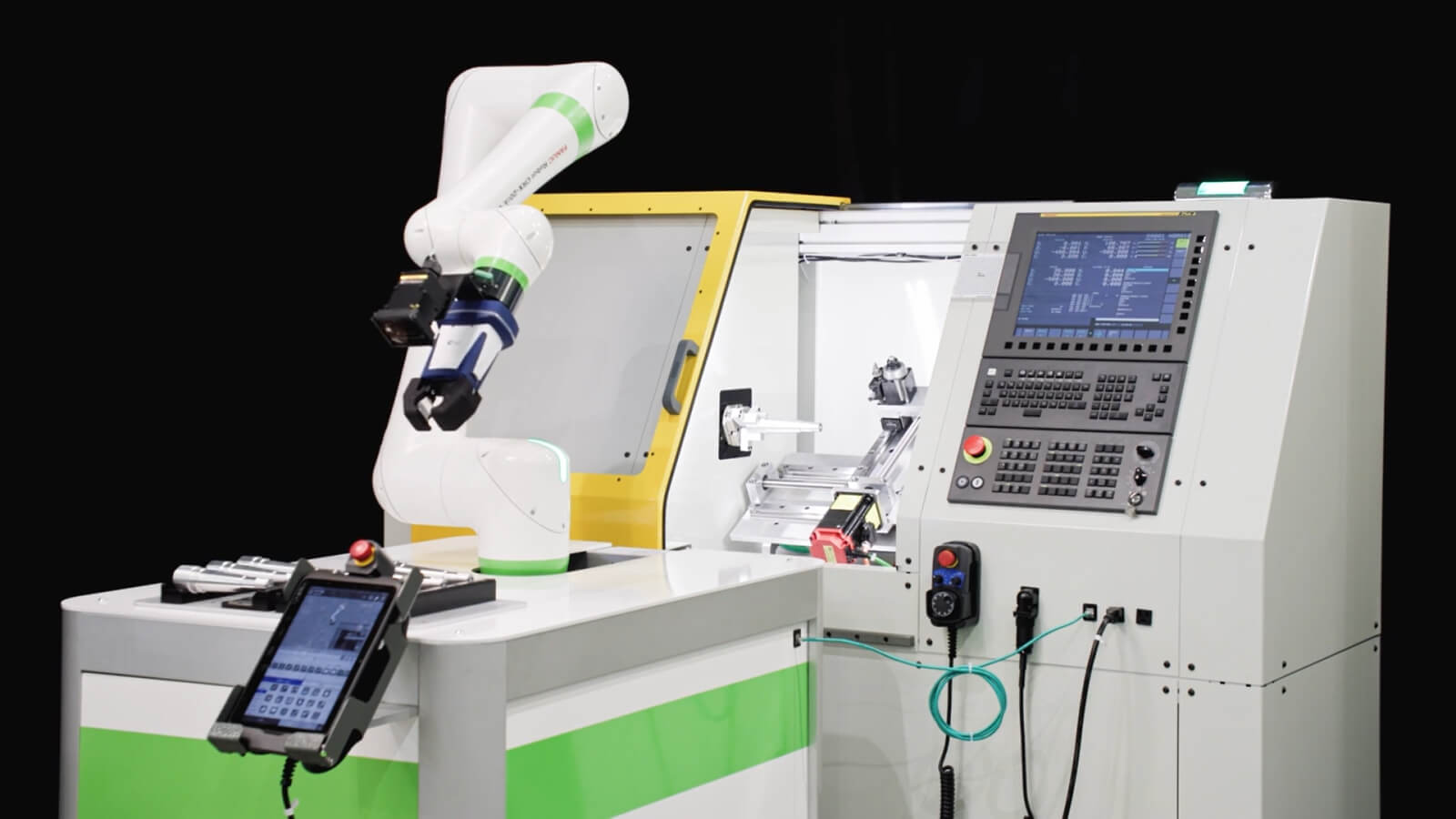

Robot CONNECT
FANUC’s Robot CONNECT feature ensures all functions are performed in a single application by programming the robot’s motion via a teach pendant. This enables the use of intelligent features like vision and FANUC’s iHMI interface to provide step-by-step robotic programming guidance.
Key Features
  • Robot motion programmed using teach pendant using traditional TPE programs
  • Able to use intelligent features like vision
  • iHMI step-by-step programming guides on robot
  • Ladder function blocks provided on FANUC Ladder III
  • Includes safety interface between CNC and Robot (Safety Function by FL-Net option needed for safety signals over Ethernet)
  • CNC Function screens on the robot and Robot Function screens on the CNC
CNCs Supported
  • 0i-F Type1 Step 2
  • 0i-F Plus
  • 30i/31i/32i/35i-B Step 2
  • 30i/31i/32i-B Plus
