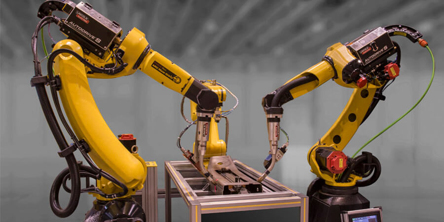

To keep a complex system running at peak performance requires routine maintenance. Your arc welding robot or cobot is just such a system. Following are a few maintenance tips that, when done properly and regularly, will help you maximize your robot’s uptime, life span, and return on investment.
Without oversimplifying things, we can begin by separating the major components of an arc welding system into two categories. The first category is the robot and controller. The second category is the actual welding process equipment.
Robot and Controller Maintenance: Daily Reviews
These items could be included on a daily inspection check list for your robot and controller.
