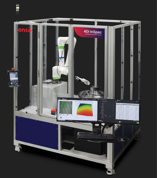

Developed in conjunction with leading aerospace and aviation engine manufacturers, the 4Di InSpec automated metrology system (AMS) combines a 4D InSpec sensor and custom metrology automation software developed by OptiPro with a FANUC collaborative robot to dramatically improve throughput. Applications perfect for this type of inspection include production, repair/rework and field measurement.
Because the measurements taken are so much more accurate and reliable than other methods, the automation cell has resulted in dramatic reductions in scrap and rework and has led up to a 40 percent improvement in yield.
For a complex part with more than 50 measurement callouts, the 4Di InSpec AMS can reduce measurement cycle time to less than 10 minutes from upwards of 12 hours using manual inspection. One user reported that 44 edge break and chamfer measurements were completed in under two minutes with the 4Di InSpec AMS—a process that had required more than 44 hours to complete manually using replication.
For larger components, an automated rotary table can be incorporated for easier handling and access to a greater number of features. Smaller components can be mounted directly to the collaborative robot and moved about a stationary 4D InSpec sensor. Because the 4D InSpec sensor is immune to vibration, quick measurements can be taken with little time between robot movements. This is critical for use in a production line, allowing the robot to move the sensor in concert with the manufacturing line without interrupting continuous production.
Because the 4Di InSpec AMS accurately captures complex feature dimensions rapidly, the system enables more precise parts to be accurately assessed, reducing inspection times and freeing up employees from hours of time-consuming manual inspections. These combined benefits of the automated measurement system using a FANUC CRX cobot has offered a return on investment of approximately two months.
