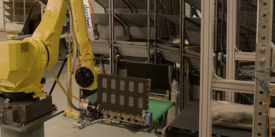

Dorabot provides integrated robotic solutions that efficiently and accurately complete the types of tasks that are often repetitive, difficult and strenuous. A prime example is the DoraSorter, a modern sortation product that features a strong, reliable and precise FANUC industrial robot equipped with a Dorabot-patented conveyor belt end-effector. Capable of sorting over 1,100 items per hour, the robot’s “eyes” are located within a scanning tunnel affixed with a high-speed barcode scanner and a high-definition RGBD camera. Using a custom rack system, the robot can deliver items weighing up to 15 pounds to 100 or more destinations including totes, bags and put walls.
