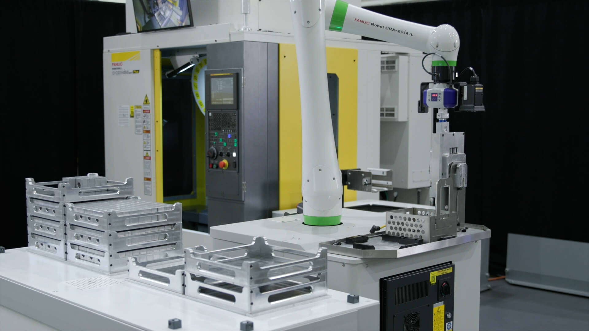

Mobile Manipulator Demonstration
FANUC recently demonstrated flexible machine tending featuring its latest CRX-20iA/L cobot mounted on a platform. An OTTO 100 AMR docked under the platform was used to lift and transport the cobot to autonomously complete a variety of common tasks found in any job shop, including part kitting, washing and machine tending. This system, designed and built by Capriol (West Bloomfield, MI), is an excellent example of how a cobot’s capabilities can be expanded, turning it into a true mobile manipulator.

CNC Servicing
There are many ways for a CNC machine to communicate with a mobile manipulator. The recent demonstration attempted to mimic a human operator as much as possible, so vision was used for communication between the CNC and the rest of the cell.
When the machine finishes a cycle, it opens the door and uses the stack light to indicate service is required. The mobile manipulator arrives at the machine and checks the light to confirm it’s ready. After completing tasks at the machine, the robot presses the cycle start button and checks the stack light a final time to verify the machine is running before it leaves the station.
Another application might use networked communication to talk to the CNC machine, potentially yielding a more efficient solution. In this case, the CNC machine can signal when it is almost finished with a cycle, and a mobile manipulator can be dispatched early so it arrives right as the machining cycle completes, improving efficiency.

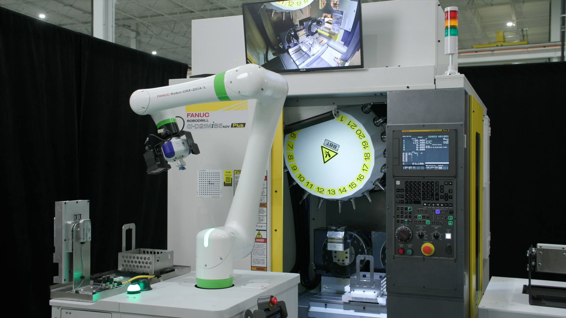

Collaborative Technology
The CRX-20iA/L used on the mobile manipulator is a power and force-limited collaborative robot. The mobile manipulator system also has laser scanners mounted on two corners offering 360-degree coverage. These two safety-rated systems (the cobot and the area scanners) can be used together to achieve a safe system.
For low-risk tasks, the FANUC cobot provides safe operation without the need for safety scanners. If higher speeds are required or the task is riskier, such as handling a sharp part, then safety scanners can be used to prevent the arm from moving when operators are near. The key here is flexibility - the power and force-limiting features of the cobot can be augmented by the area scanners to achieve a safe system in a way that makes sense for each unique application.
CRX 20i A L Machine Tending Cobot
