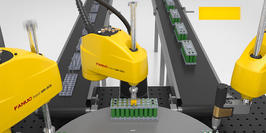

  5. How to Know When A SCARA Robot is the Right Choice for Your Application
Scara robot article
There are several factors to consider when selecting the right robot for your application. Follow these guidelines to make your choice easier.

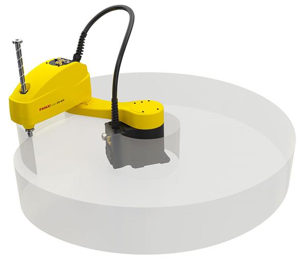

The work envelope or the area of space that a robot can physically reach is a critical consideration. Whether SCARA, Delta Robots, or six-axis robots, the lengths of various links, and the limitations of the joint motion are important factors to review.
Typically, SCARA robots have a cylindrical shaped work envelope with variations in the diameter and depth of the cylinder. The total lengths of arms one and two define the diameter of the circle, while the Z stroke defines the depth of the cylinder. (See FANUC SCARA Work Envelope)
Fanuc scara work envelope
FANUC SR Series SCARA Robot Work Envelope
In most applications, a SCARA’s work envelope is contained to the front and side. The back area may not be useable if cables and pneumatic hoses exit from the rear - some SCARAs offer optional bottom exits – making it possible to work behind the robot.
