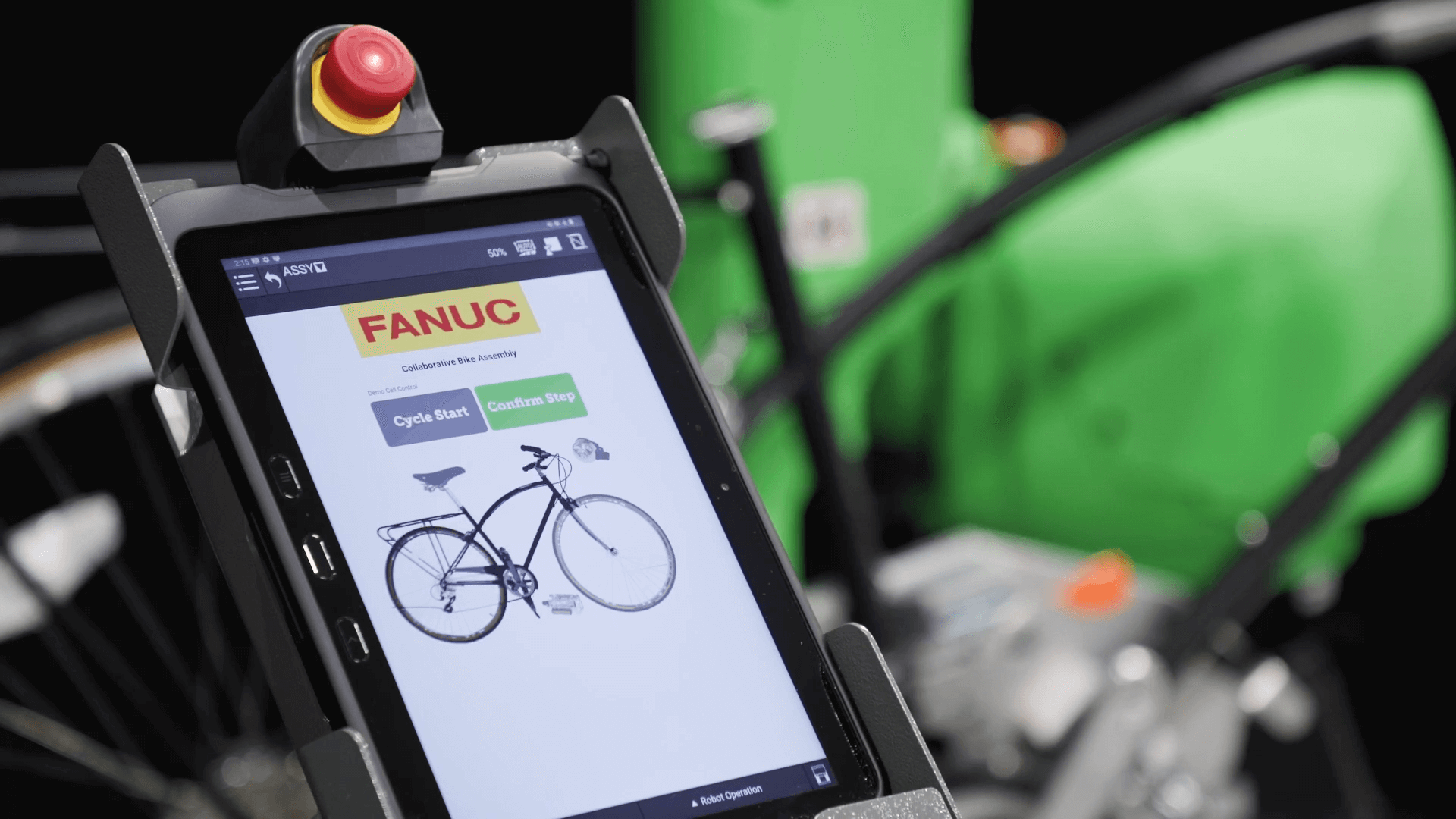

In FANUC’s CR-35iB collaborative robot bicycle assembly demonstration, we created icons on the custom HMI that prompt the user to assemble and inspect the bicycle at certain points in the program after the robot had oriented the bicycle for convenient access for the user.
Additionally, a custom work cell HMI can be created using Plug-in SDK, as we also did in the bicycle assembly demonstration. In the video, you can see where the user checks each step along the assembly process. When finishing one step, a “confirm” button is pressed on the custom HMI, and the robot moves to the next assembly position, where a new set of instructions is displayed. These elements on the Tablet TP were all created via Plug-in SDK.
Custom icons can also be created, which are geared towards your application and can output a custom error. These icons on the Cobot’s Tablet TP can be programmed to complete whatever action you need.
