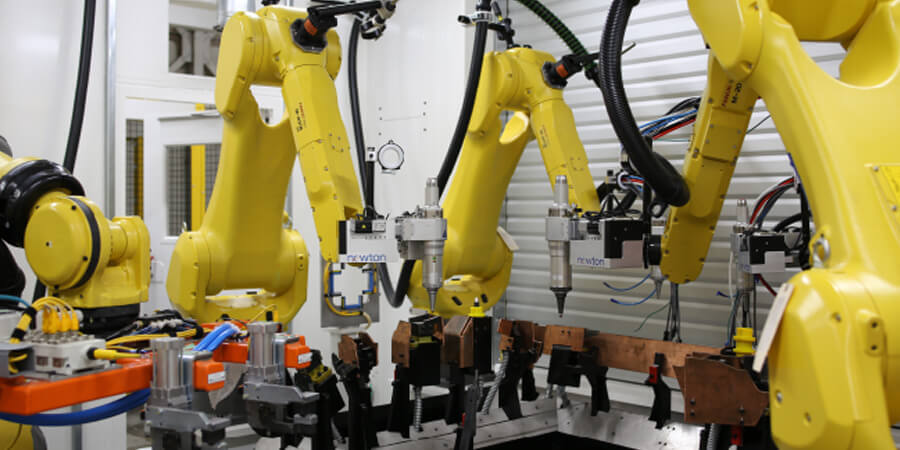

The latest improvement in robotic laser cutting performance comes from a company called Shape Process Automation (formerly DRS Robotics). Shape collaborated with Laser Mechanism and FANUC America to develop the NEWTON – Robotic Cutting Head. NEWTON is a robot-mounted 2-axis shape-cutting device that offers path accuracy up to +/- 0.05mm within a 30mm operating range. The device is also capable of the fastest laser hole cutting speeds at 0.3 seconds for common size features. The FANUC M-20iB/25 robot already has impressive path performance and the NEWTON takes it into new territory. This capability nearly eliminates the gap between robotic and CNC laser cutting for 3D automotive type components.
New developments in robotic cutting continue to close the gap on path accuracy with speed, taking the robotic to CNC performance levels and with higher throughput.
The NEWTON design is a patent-pending device that is inertial balanced, and controlled directly from the robot teach pendant. The operation is simple with pre-canned motion planning for common shapes including circles, slots, squares, hexagons, and many others in the robot’s library.  For users it is as simple as moving the robot head to the feature and then selecting the cutting shape from the library.  The shape attributes are easy to modify to make quick programming.  Robot users will easily transition to the NEWTON because the programming is familiar and easy to use. NEWTON can reduce the cycle time over a typical six-axis cutting robot by as much as 70%.

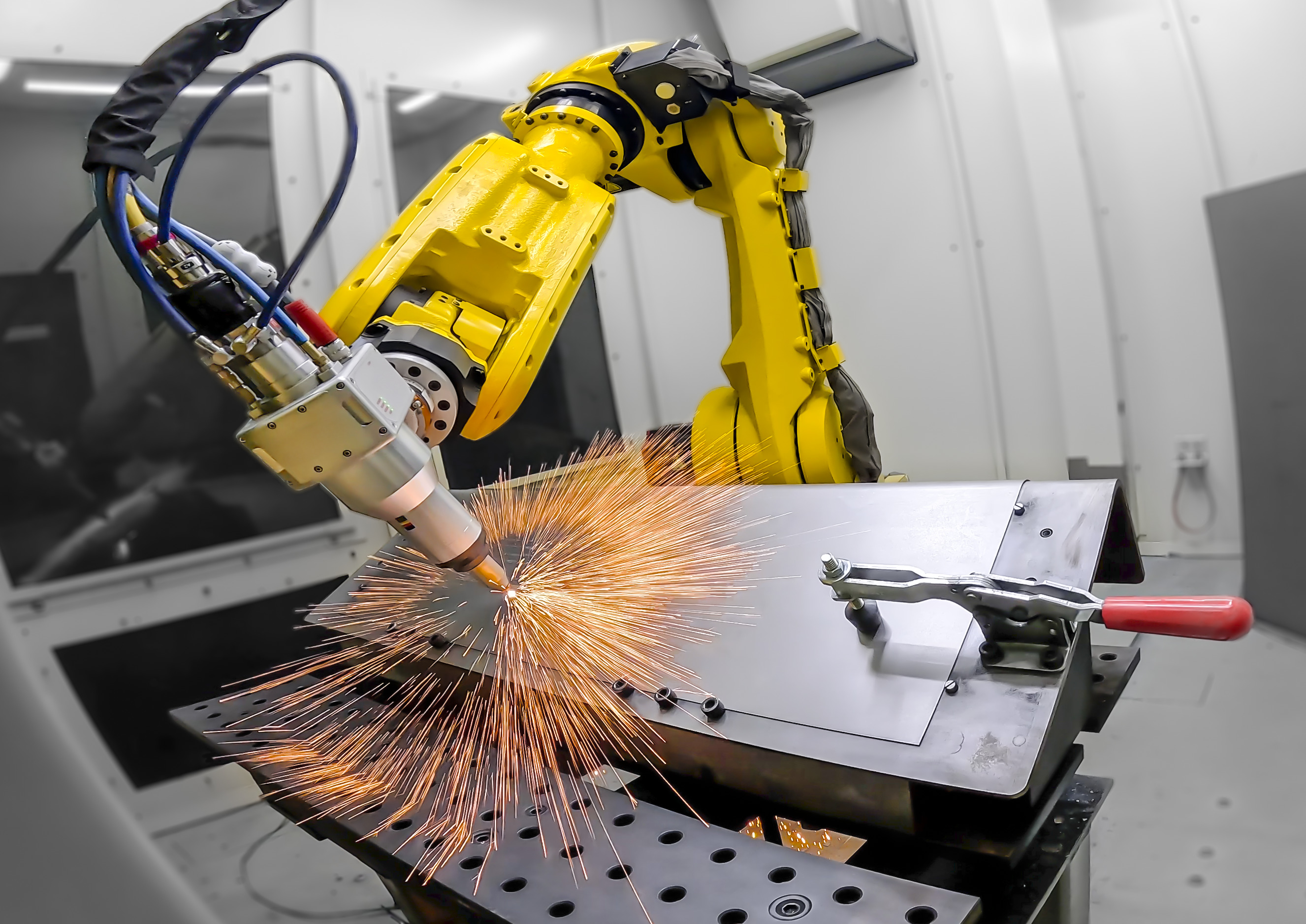

M 800 Laser Cutting
FANUC M-800iA/60 industrial robot performing laser cutting
