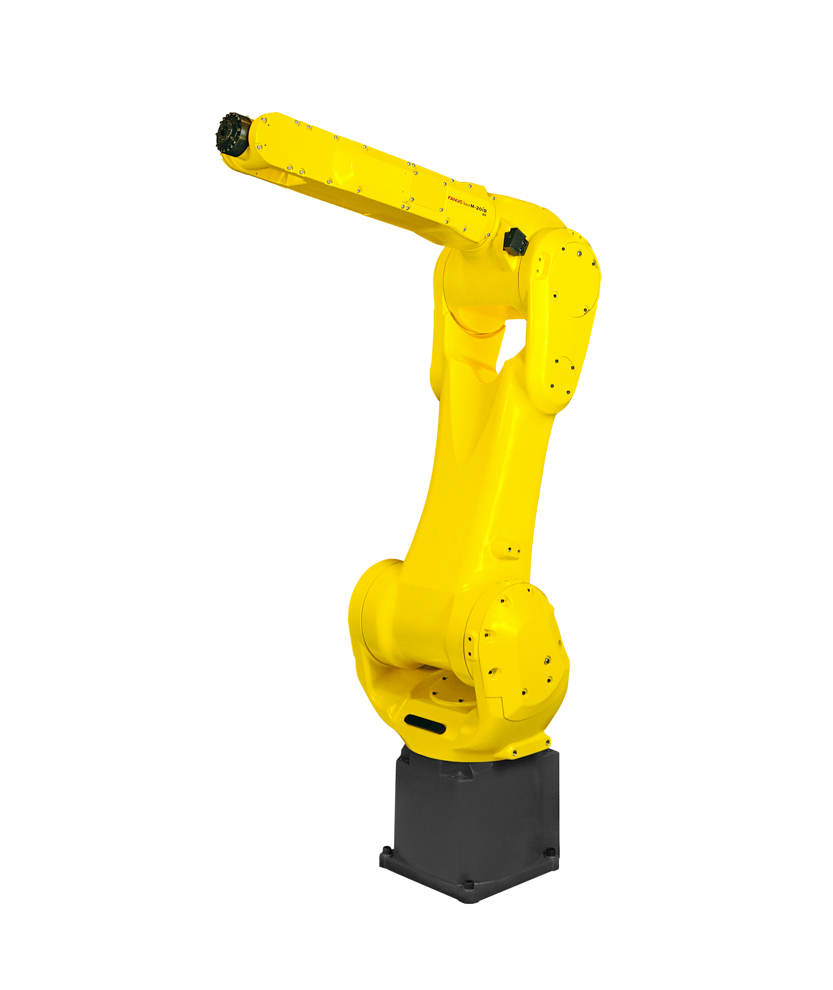

M-20 Series
M-20iB/25
25 kg
1853 mm
210 kg

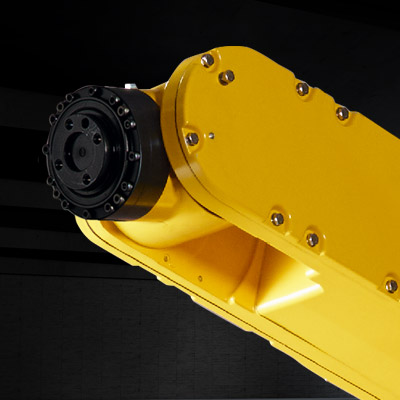

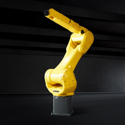

Combining a lightweight hollow upper arm and wrist with advanced servo technology, the FANUC M‑20iB/25 is engineered for faster cycles and increased throughput across a wide range of manufacturing applications. With a 25 kg payload and an extended 1853 mm reach, it delivers exceptional performance in tasks requiring both strength and precision.
The M‑20iB/25 is fully encapsulated to IP67 standards, making it ideally suited for wet, dirty, and harsh environments, including demanding processes such as automatic deburring. Its compact, high‑rigidity design ensures stable operation and long‑term reliability in challenging production settings.
Fea ro pr m20ib25 l 2
Enhanced performance
Compared to the previous M-20iA model, payload has increased from 20 kg to 25 kg and axis speeds gone up by 21 percent.
Fea ro pr m20ib25 l 6

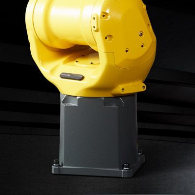

Enclosed construction
NO exposed cables and motors for minimal interference and maximum reliability. Connectors don’t protrude, and the cables are shielded along the arm.
Fea ro pr m20ib25 l 3
Demanding environments
Options for demanding environments and processes such as clean room, food handling and parts washing are available.

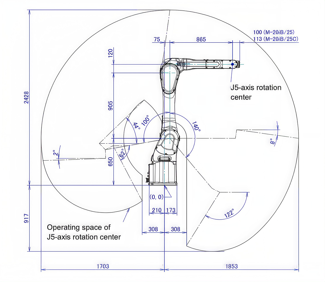

25 kg
Floor / Ceiling / Angle
±0.02 mm
1853 mm
210 kg
1 kW
340°
240°
303°
400°
290°
540°
205°/s
205°/s
260°/s
415°/s
415°/s
880°/s
51/2.2
51/2.2
31/1.2

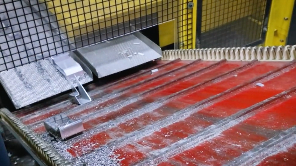

Aluminum Cast Cutting
A FANUC M‑20 robot uses a FiberCUT® RAa head to focus a fiber laser and cut metal while maintaining automatic nozzle standoff.
Laser Mechanisms
Video courtesy of Laser Mechanisms
