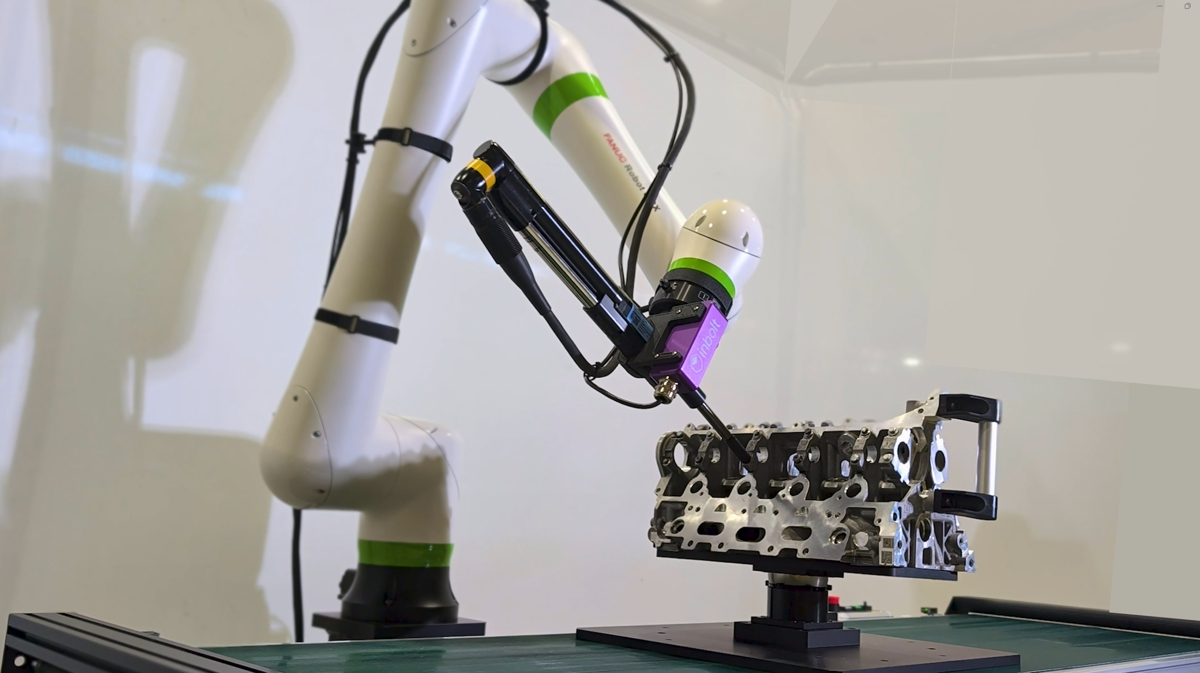

Real-time control is only half of the problem. To correct a robot's path on the fly, something has to see the part quickly, accurately, and without custom lighting or fixturing. That is where Inbolt has built one of the more interesting applications running on top of STMO.
Inbolt mounts a compact 3D camera on the robot wrist, runs its AI vision model to localize the part in the part's own reference frame, and streams corrected joint commands into the controller through Stream Motion. The robot tracks parts moving down the line and executes the planned trajectory (screw insertion, bolt rundown, glue application, de-racking) without indexing, halting, or re-teaching.
This is not confined to lab demos. Inbolt's solution is already deployed on leading automotive lines, with multiple major projects in production using CRX cobots for dynamic applications. The system handles part variability, imperfect environments, and the crowded General Assembly stations where conventional automation either doesn't fit or doesn't pay back. Inbolt's solution runs today on the R-30iB Plus controller that ships with CRX, with industrial-yellow and R-50iA support landing next.

If you want to see Stream Motion in action, Automate in Chicago, June 22–25, is the place. FANUC's Booth #1401 will run a CRX-20iA/L performing real-time bolt tightening on a moving engine block, with Inbolt's robot intelligence and NVIDIA-powered processing in the loop. The Inbolt Booth #1675 will run three additional CRX demonstrations: dynamic dispensing on a moving engine, real-time workpiece tracking, and de-racking — each programmed from CAD and executed live.
