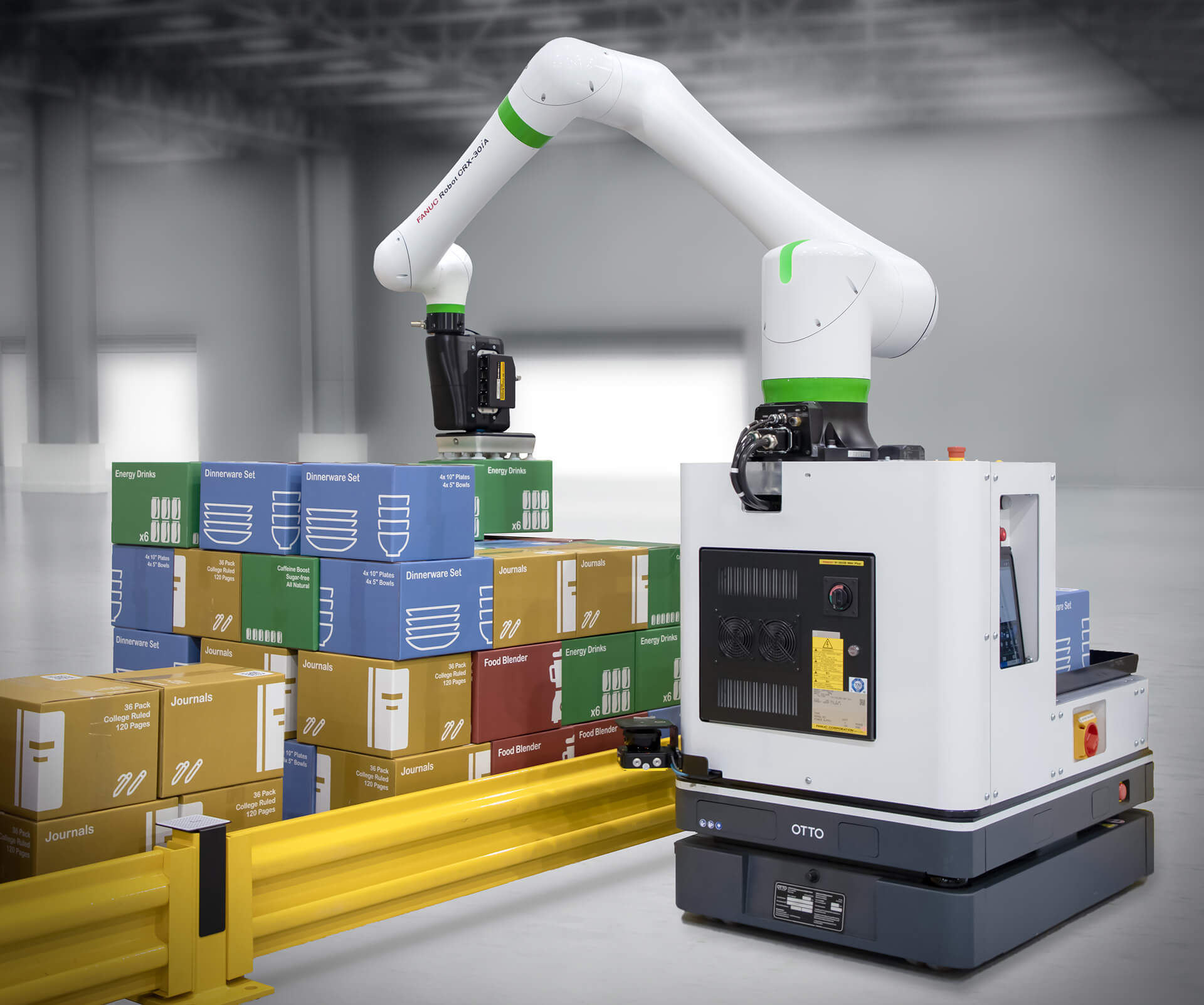

CRX-30iA Mobile Manipulator Demonstrates Palletizing
New to FANUC’s product demonstrations is the CRX-30iA mobile manipulator demonstrating palletizing with a fully integrated robotic Autonomous Mobile Robot (AMR) system engineered for warehouse, fulfillment and distribution environments. This solution takes on ergonomically challenging jobs that traditionally put strain on employees while delivering high throughput.
AI-driven perception tools, including payload estimation, box-locating vision, and barcode-based decision logic, allow the CRX-30iA and OTTO 600 AMR from Rockwell Automation to adapt automatically to varied box sizes, pallet conditions, and routing requirements. The system’s intelligent safety architecture uses area scanners and smart speed control to maintain high-speed operation when the area is clear and slows automatically when workers approach, enabling safe, fenceless collaboration.
The demo combines the high-payload CRX-30iA collaborative robot with the OTTO 600 AMR to pick, weigh, transport, palletize, and sort boxes. The CRX-30iA operates at its top collaborative speed, while the AMR can travel up to 2 meters per second to support efficient intralogistics performance. Technologies included are:
  • A robot-mounted 3DV/400 sensor for box locating
  • CRX-30iA palletizing from quarter pallets
  • Payload estimation and compensation for flexible handling
  • The AMR transporting multiple boxes at once and building full pallets
  • iRVision barcode scanning for routing, sorting, and verification
  • Full repalletizing and depalletizing sequences (quarter pallet to full pallet)
  • AI-assisted perception for dynamic box recognition, accurate positioning, and adaptive palletizing logic
This system demonstrates how collaborative robots and AMRs streamline intralogistics through flexible box handling, mixed pallet building and autonomous transport while maintaining safety and efficiency.
