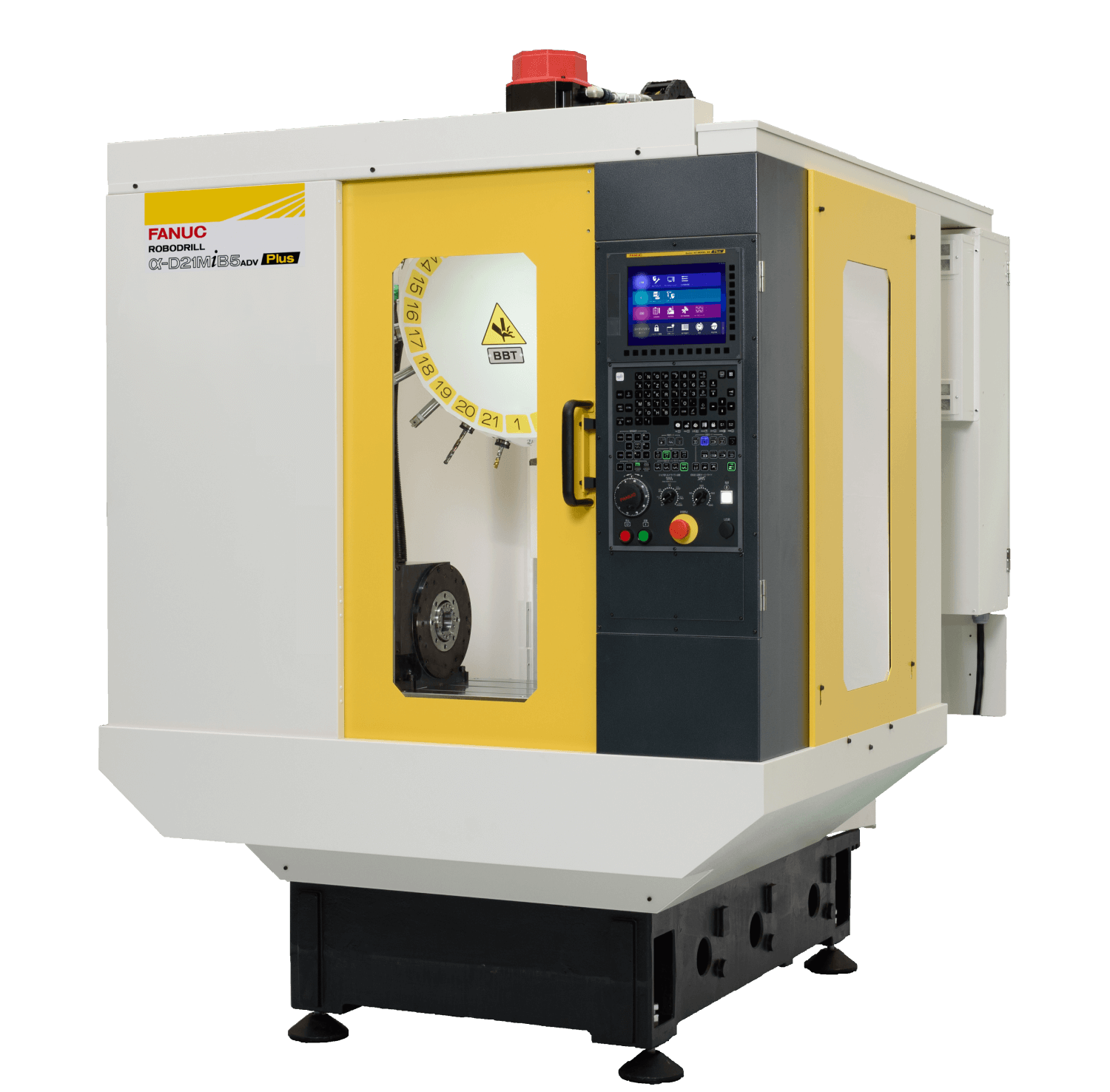

Compatible controller: ROBODRILL 31iMB5 Plus
α-D21MiB5 ADV Plus
Axis Travel (X/Y/Z)
500/400/400 mm
Max Spindle Speed
24000 High Speed min⁻¹
Tool Capacity
21
Tool Change Time
0.7 s
Fitted with a standard bed, the machines are the ultimate all-rounders, helping increase productivity for a wide range of milling and drilling tasks requiring maximum precision, versatility and reliability. Multipart clamping makes them highly adaptable.
Compatible Controllers
Axis Travel (X/Y/Z)
500/400/400 mm
Table Size X
650 mm
Table Size Y
400 mm
Max Table Load
400 kg
Machine Mass
2250 kg
Max Tool Length
250 mm
Max Tool Diameter
80 mm
Max Tool Mass
4 kg
Total Mass
30 kg
Number of Tools
21
Max Programmable Cutting Feed
30000 mm/min
Tool Change Time
0.7 s
Air Pressure
72 psi / 0.5 MPa
Distance Spindle Nose to Table
80-480 mm
Spindle Speed
Spindle Holder
BBT30
X-Axis Rapid Traverse
54 m/min
Y-Axis Rapid Traverse
54 m/min
Z-Axis Rapid Traverse
54 m/min
Axis Positioning Accuracy
< 0.006 mm
Axis Positioning Repeatability
< 0.004 mm

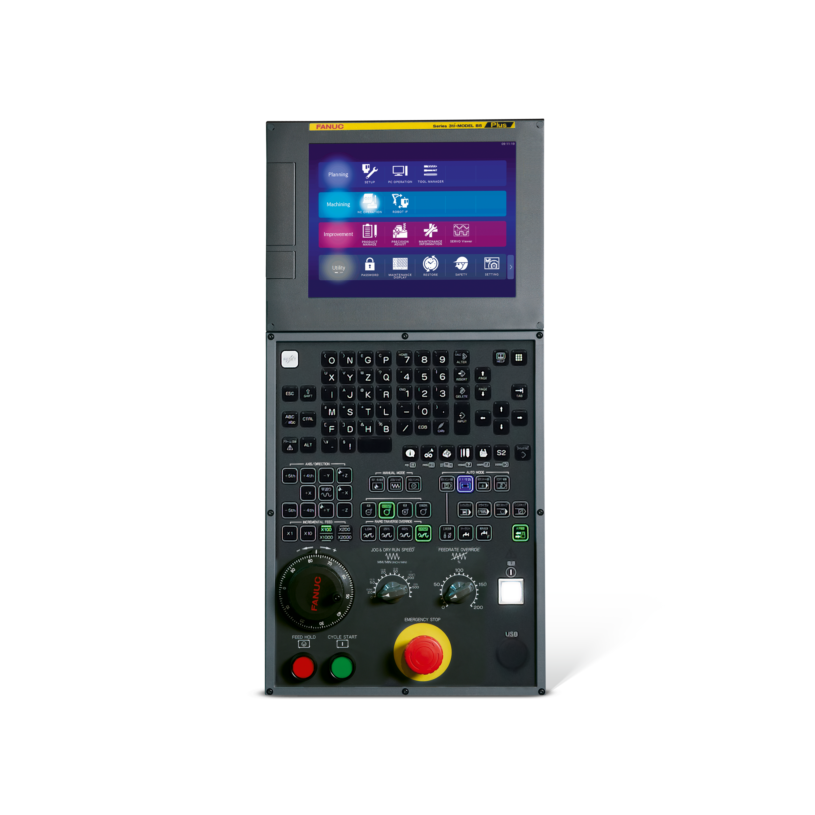

FANUC Series 31i MODELB5 Plus ROBODRILL
Controllers
The FANUC ROBODRILL 31i-B5 Plus control delivers faster cycles, higher uptime, and automation-ready performance backed by proven FANUC reliability.
