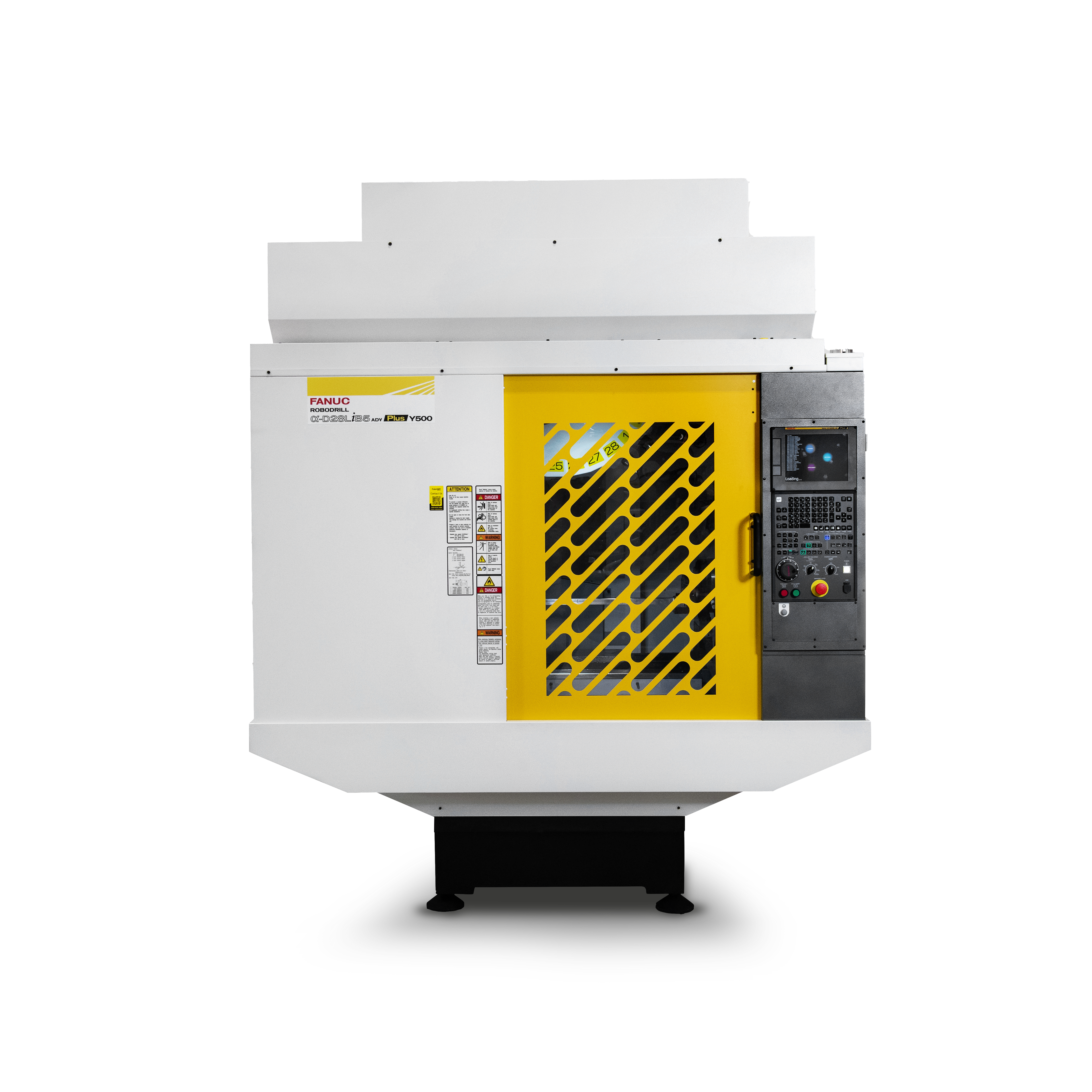

α D28LiB5 ADV Plus Y500
Axis Travel (X/Y/Z)
700/500/400 mm
Max Spindle Speed
24000 High Speed min⁻¹
Tool Capacity
28
Tool Change Time
0.7 s
With a Y-axis stroke of 500mm and a tool storage capacity of 28 tools, the α-D28LiB5ADV Plus Y500 ROBODRIL is designed to perform a wider range of tasks and boost productivity for any machining application. The extended Y-axis stroke by 100 mm and the larger table size unlocks the ability to machine large workpieces without significantly increasing the VMC’s footprint. Plus, the expanded tool storage with ultra-fast changes ramps up this model’s versatility and efficiency.

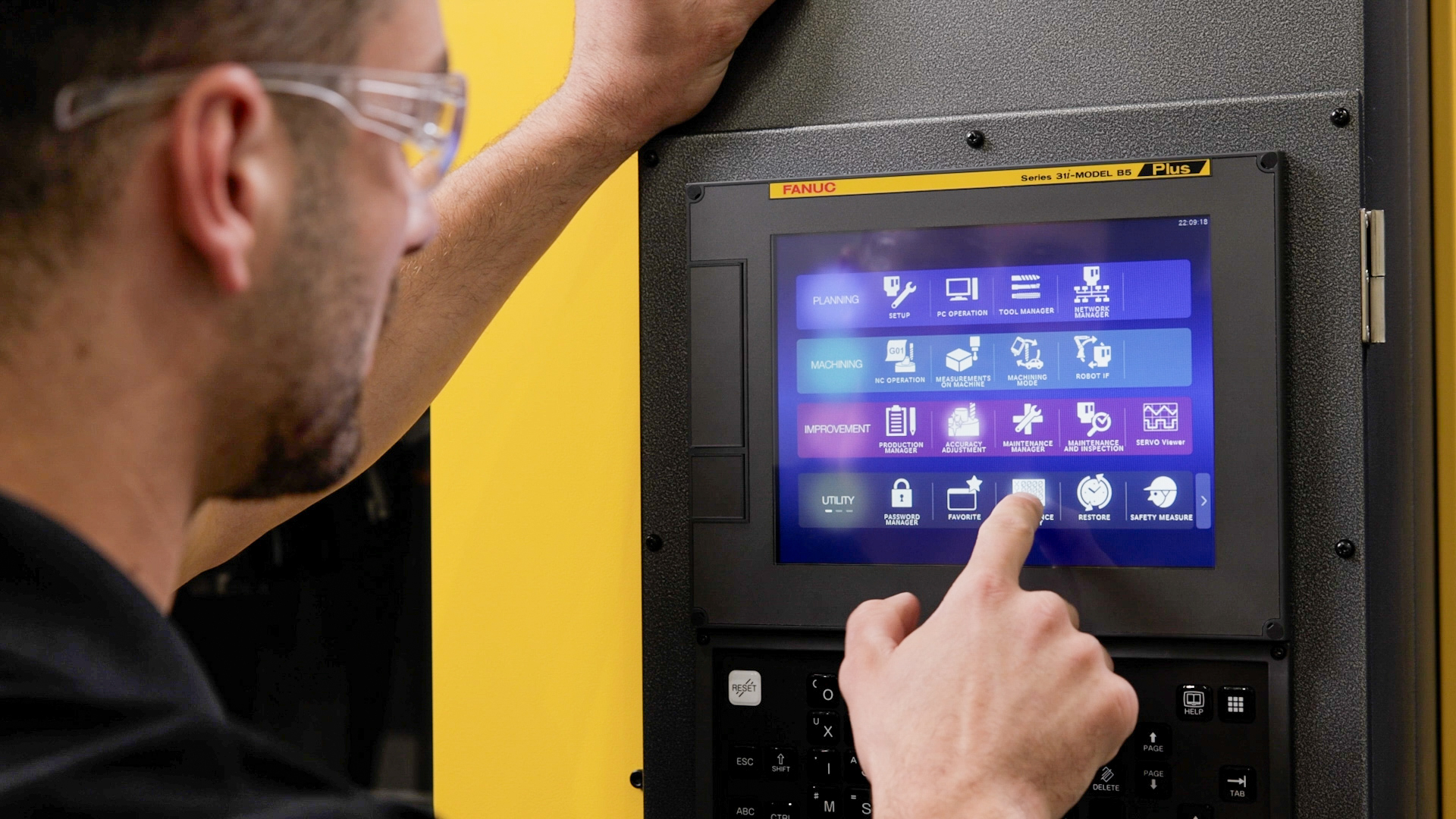

Compatible Controllers
FANUC Series 31i MODELB5 Plus ROBODRILL
Controllers
ROBODRILL 31iMB5 Plus
The FANUC ROBODRILL 31iB5 Plus control delivers faster cycles, higher uptime, and automation‑ready performance backed by proven FANUC reliability.
