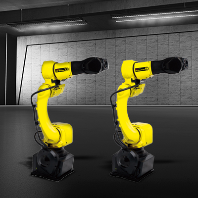

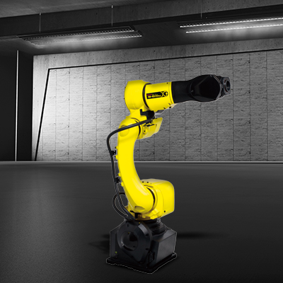

Made specifically for compact work spaces, this highly versatile robot can also be used for top mount applications. Moreover, the enhanced hollow wrist design supports payloads up to 16 kg, which is a significant improvement compared to its predecessors and the best reference in its class.
M10id16s 400x400
High rigidity
Minimum vibration even with payload increased by 25% compared to its previous model.
Both 400x400
Ideal choice for compact robotic cells
The slim profile and footprint combined with the high payload capacity make the robot the perfect fit for compact robotic cells. For very compact welding applications the equivalent Arc Mate 100iD/16S robot model is available.

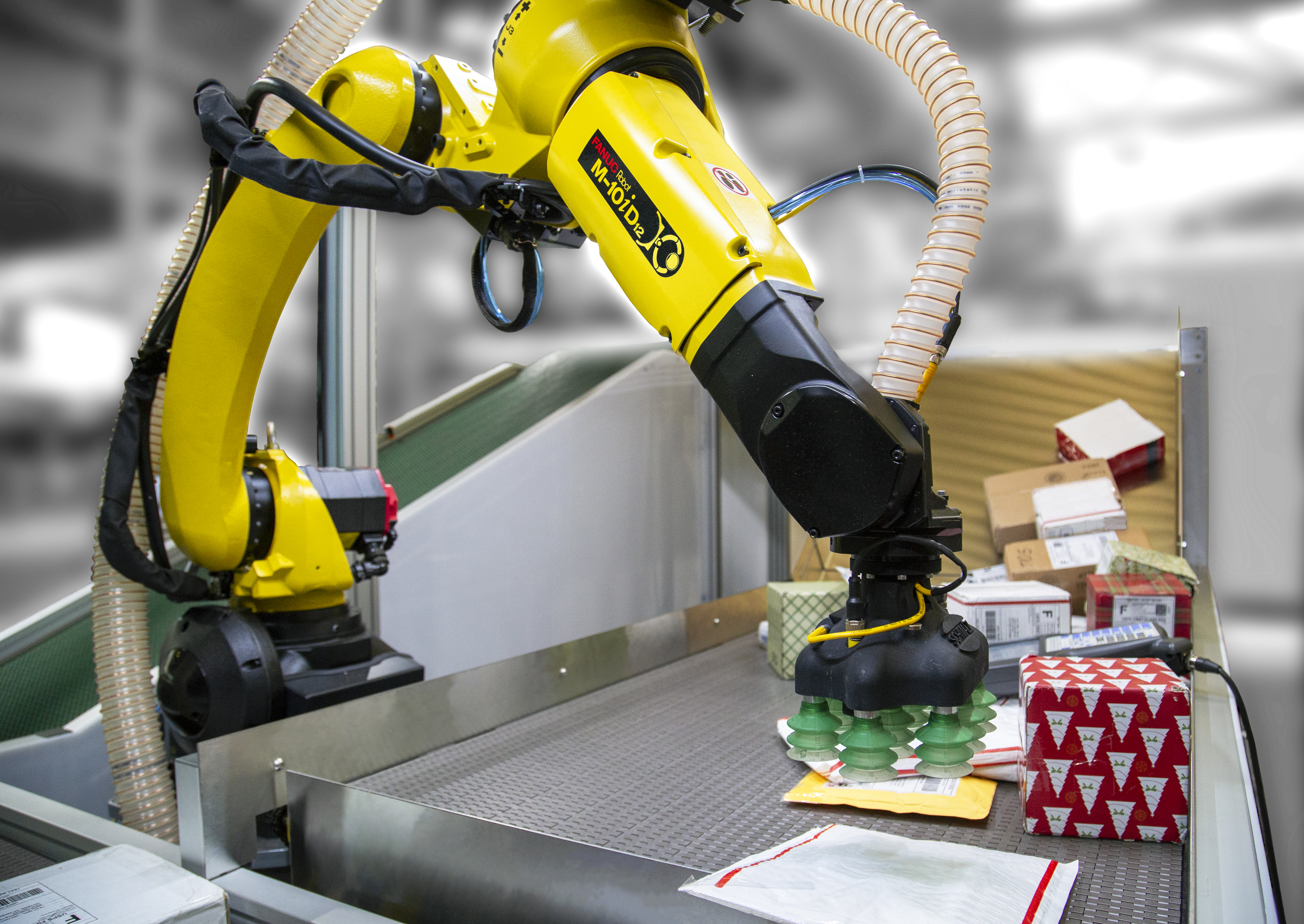

A strong wrist for handling
Capable of lifting up to 16 kg, the M-10 series' heavy-duty wrists make it ideal for loading and unloading operations.

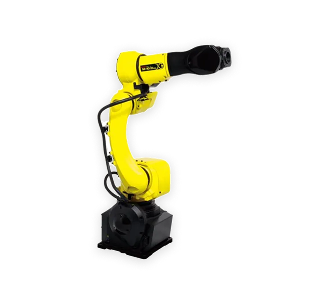

16 kg
±0.02 mm
1103 mm
140 kg
1 kW
340°
235°
455°
380°
360°
900°
290°/s
270°/s
270°/s
430°/s
450°/s
730°/s
26/.9
26/.9
11/.3
IP54
