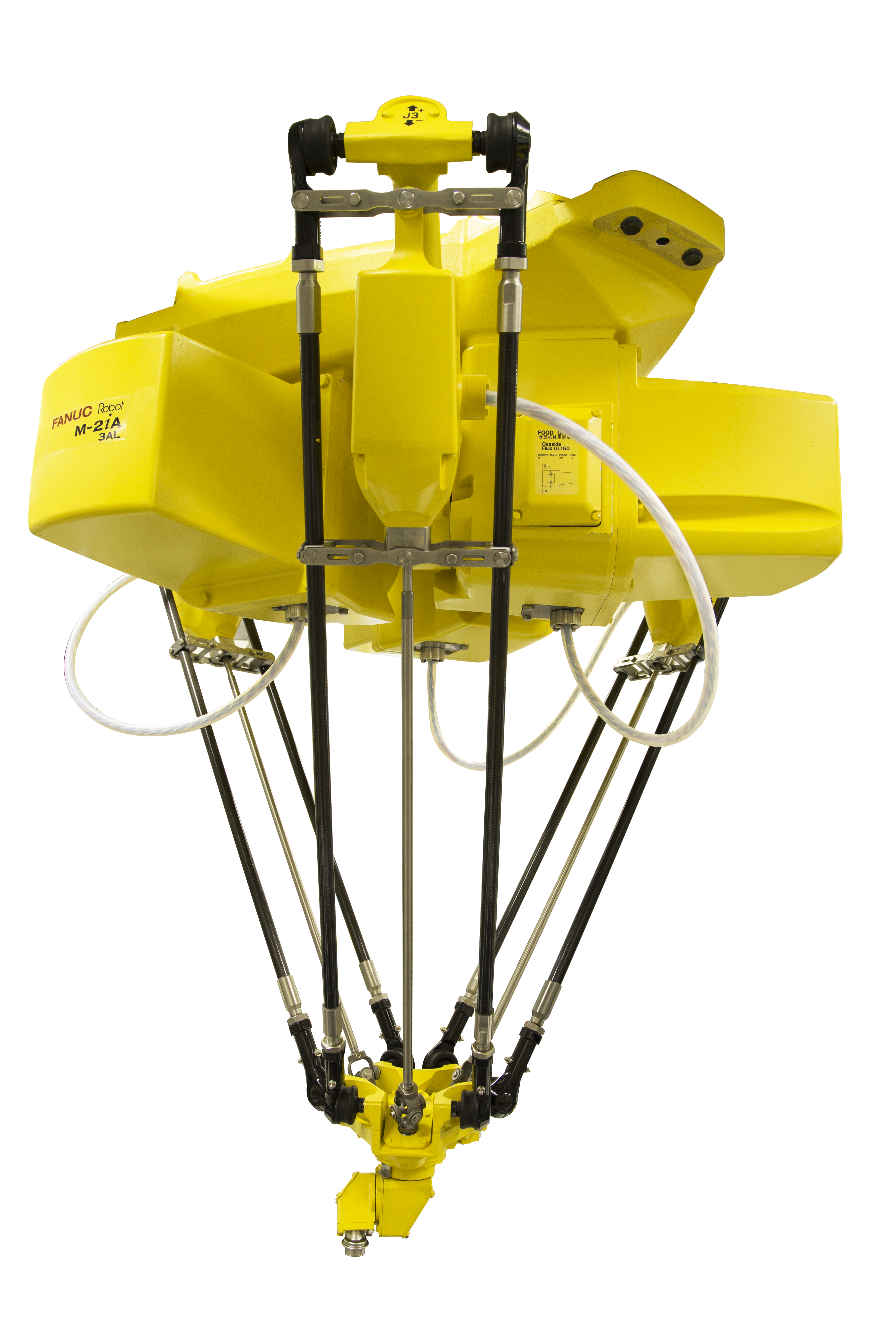

This high-speed 6-axis delta robot is perfect for picking, packaging and assembly. Its 3-axis wrist means it is capable of freely rotating workpieces and tools as required for assembly applications. Its clever design also means it makes best use of available workspace.
  • Unique 6-axis structure
  • Wrist with fast rotate motion
  • IP69K protection
  • High-reliability design
  • Common installation and wrist interface with 4 axes types
  • Common motion area with 4 axes types
Best-in-class full articulation
The long-arm M-2iiA/3AL is equipped with a three-axis articulated wrist for applications that demand high levels of flexibility from delta robots. This wrist enables it to achieve best-in-class full articulation.
Ideally suited to assembly
M-2iA/3AL models come with a three-kg payload and six-axis design. This makes them ideally suited to picking and assembly operations.
3 kg Payload
Despite their extended reach, FANUC M-2iA/3AL picking and assembly robots can pick products weight up to 3 kg at high rates.
Smart Offline Programming
Compatible Controllers
R-30iB Plus Mate Cabinet, R-30iB Plus A-Cabinet, R-30iB Plus Mate Open-Air Cabinet
3 kg
Ceiling
±0.03 mm
1130 mm
140 kg
3 kW
0°
0°
300°
1700°/s
1700°/s
1700°/s
STANDARD / OPTIONAL / IP67 / IP69K
