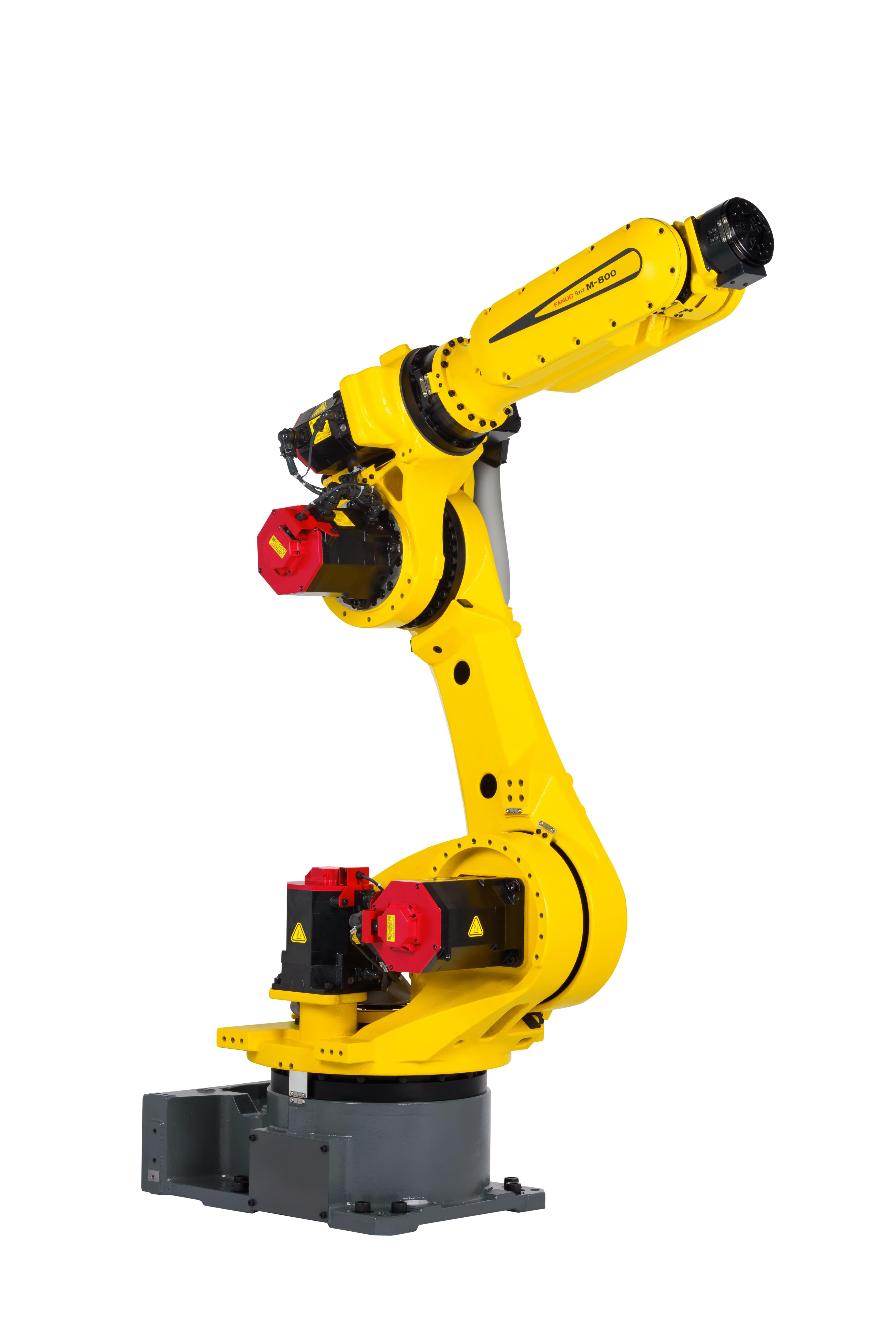

M-800 Series
M-800/60-20B
60 kg
2040 mm
820 kg
The M-800/60-20B provides outstanding accuracy and enhanced rigidity, enabling manufacturers to improve the quality of high-demand processes such as laser cutting, welding and machining—without slowing down production.

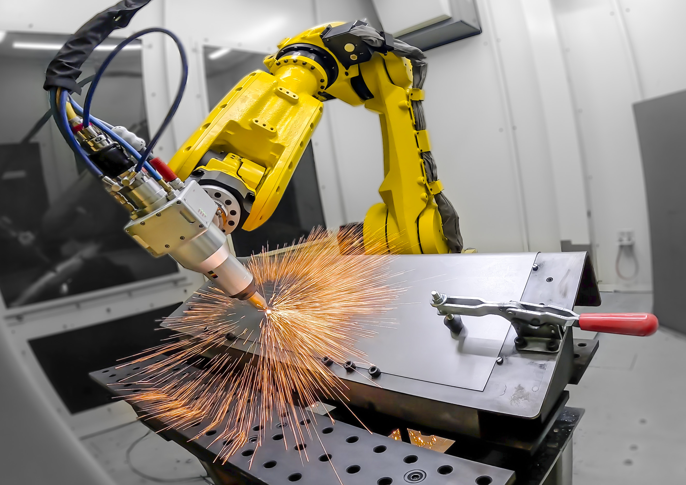

M-800iA/60 Laser Scanning Demo
FANUC M-800iA/60 robot demonstrates laser scanning inspection of metal parts with precise, controlled motion.

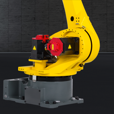

High Precision
Thanks to its highly rigid and robust construction, the M-800/60-20B delivers excellent accuracy and performance.

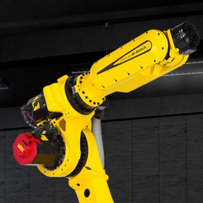

Absolute Precision Accuracy
The calibration technology FANUC iRCalibration Signature is included as a standard.

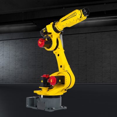

High Performance
Its excellent motion performance, especially in narrow corners, makes it ideally suited for high-accuracy path applications such as 3D laser cutting.

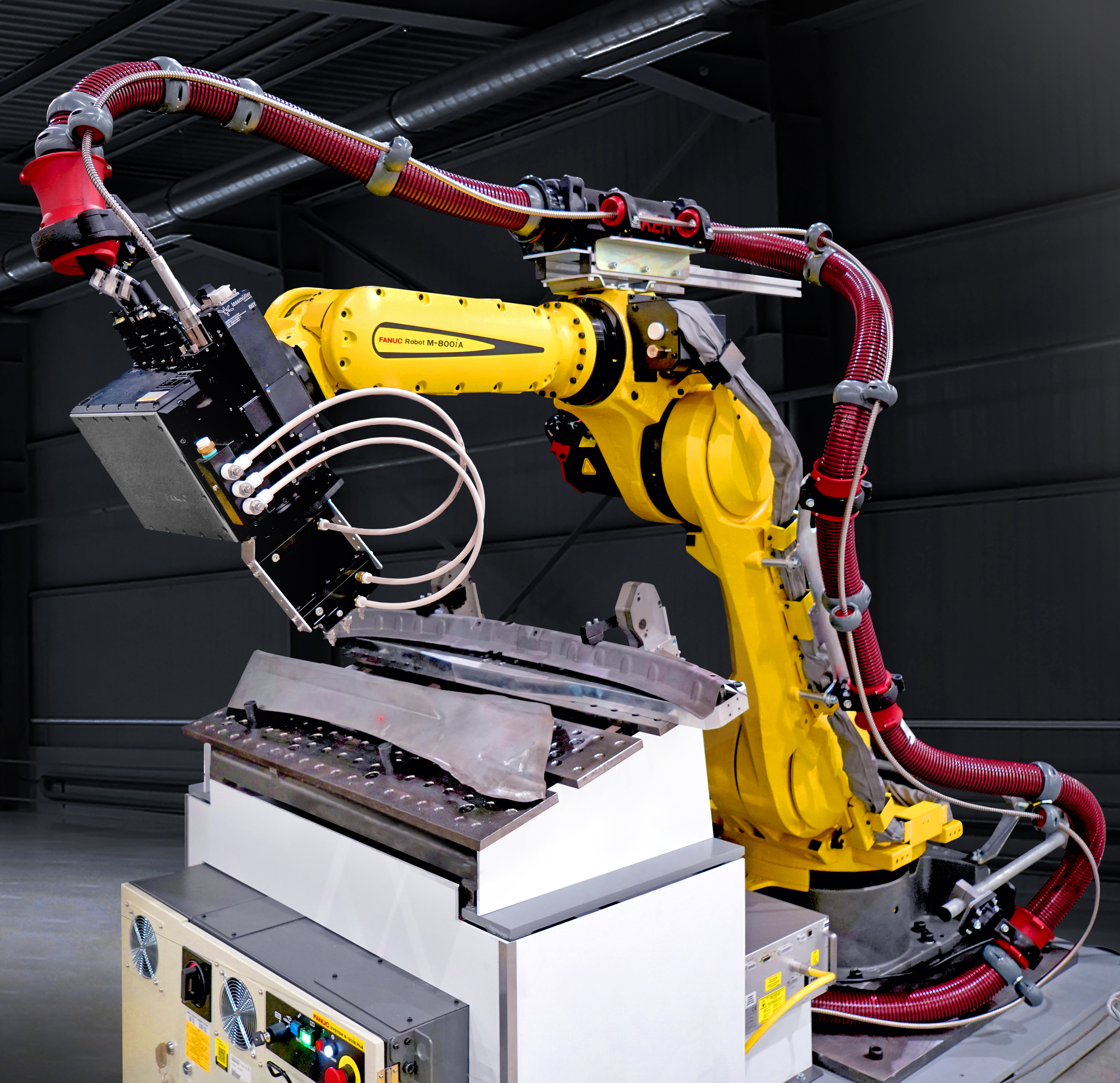

The M-800 Series
The FANUC M-800 Series delivers superior path accuracy for precision applications without compromising production speed.
