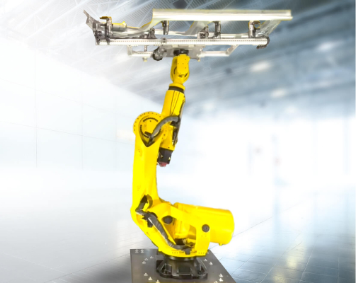

M-950/500F-28A
500 kg
2830 mm
2500 kg
The M-950/500F-28A is a heavyweight champion, designed to handle substantial payloads with precision. It offers an impressive 500kg payload capacity and a 2830mm reach, making it ideal for tasks that involve lifting and moving large, heavy objects.
M-950iA/500 - Friction Stir Welding Demo
A FANUC M-950iA/500 robot performs friction stir welding as it guides a welding tool along the joint with controlled force.
M 950ia 500 automotive side panel handling
Serial Link Mechanism
Unlike standard parallel-link robots, the M-950/500F-28A is a serial-link robot. This design offers a wider range of motion, allowing it to extend its arm upright and rotate backward with minimal interference. This type of flexibility makes it adaptable to various layouts and enables installation in tight workspaces.
