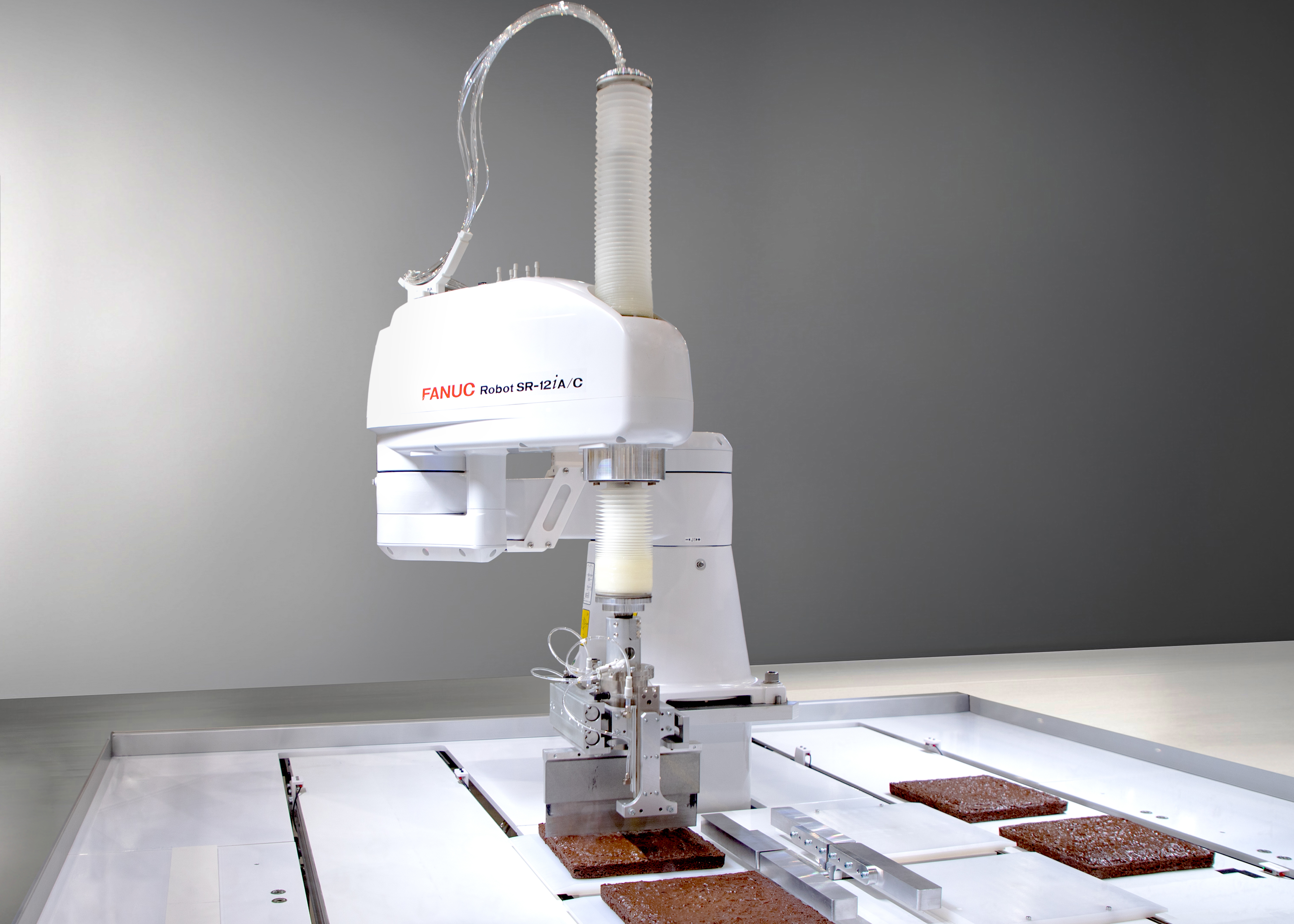

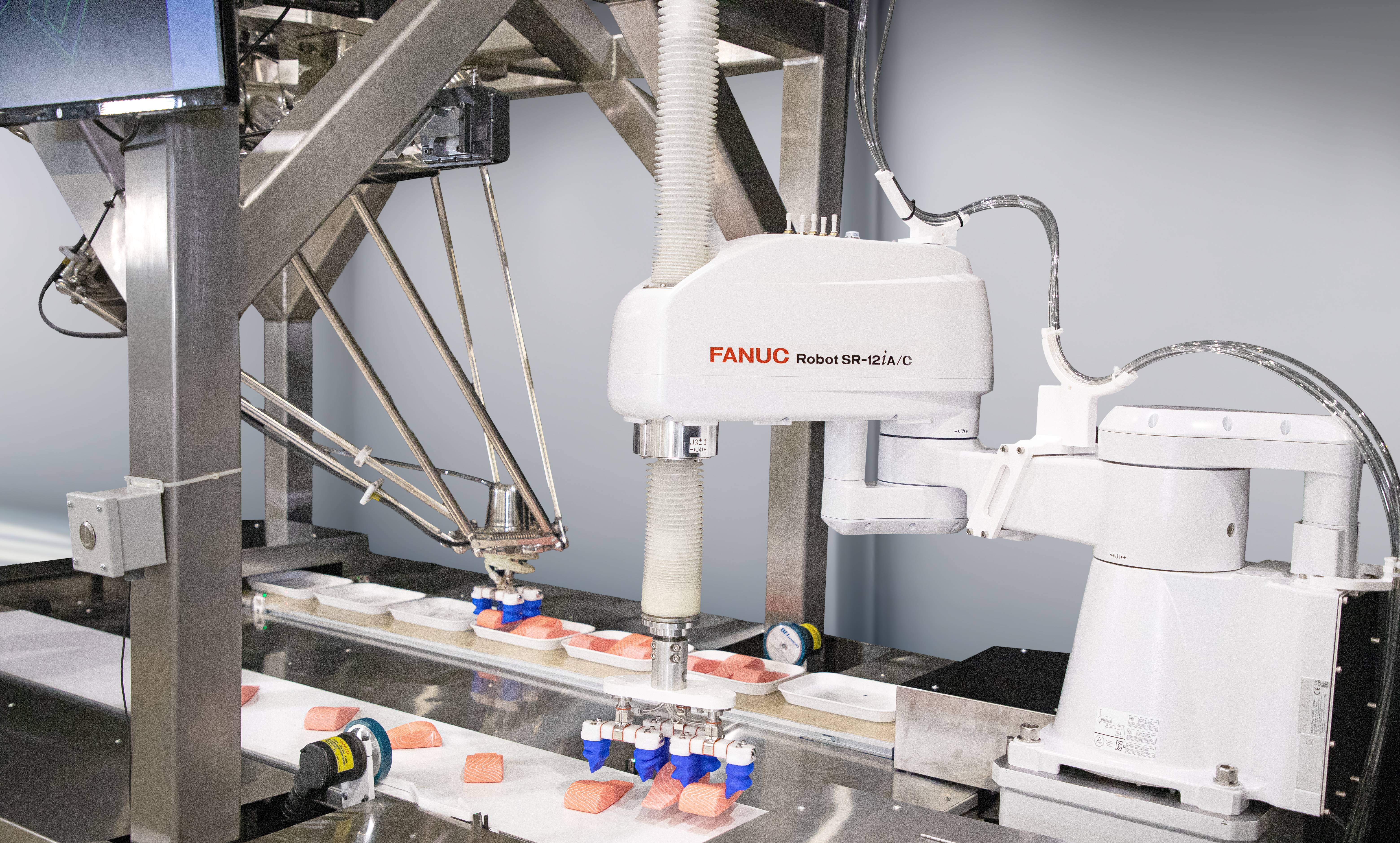

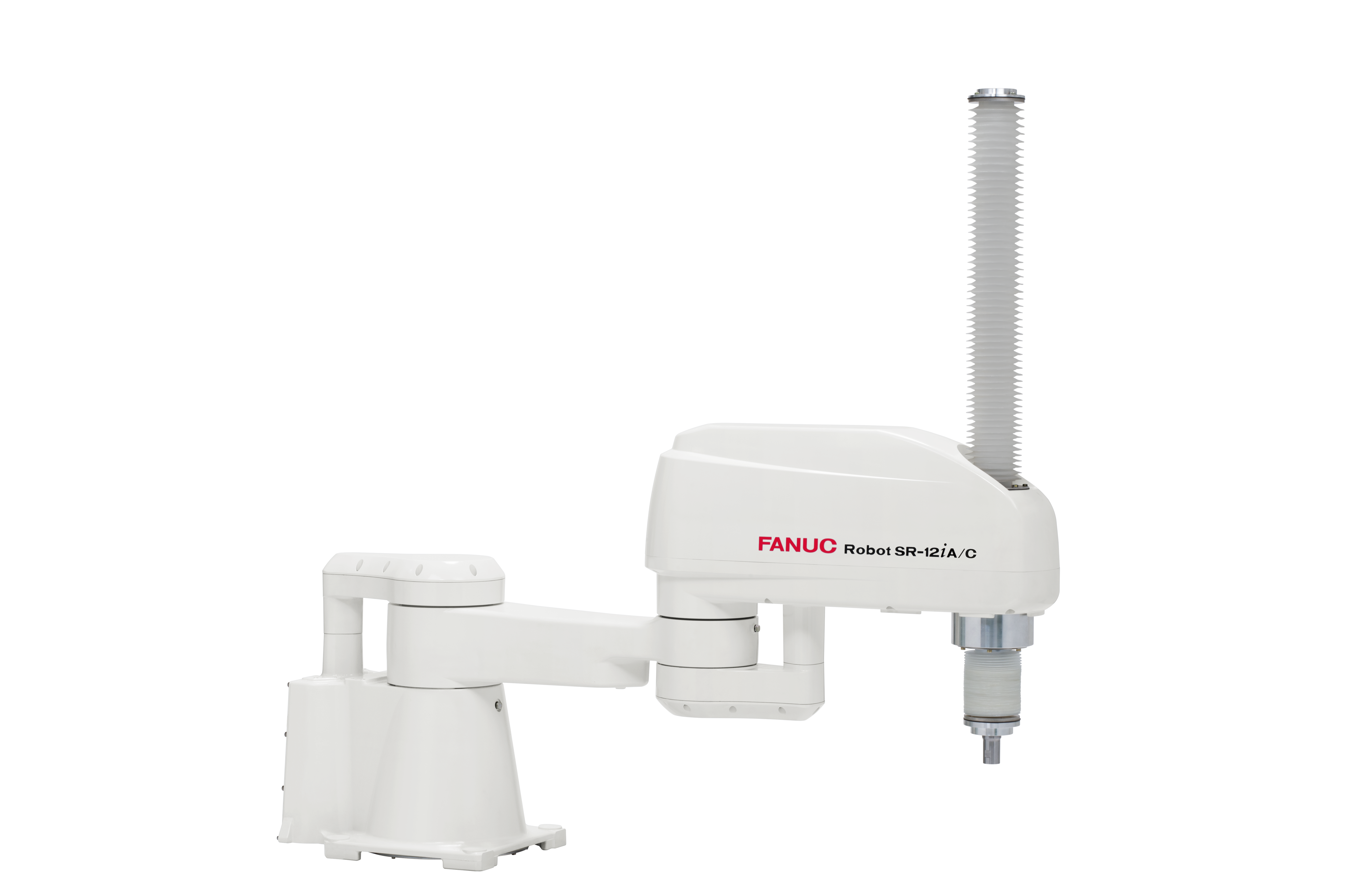

In addition to lightning-fast operation, the new SR-12iA/C Food Grade SCARA robot offers a robust construction, corrosion resistance, ease of cleaning, and compliance with food safety regulations to provide a reliable and efficient solution for food companies.
The SR-12iA/C is coated with white epoxy paint and uses NSF H1 food grade lubricant on all axes. In addition, it features an IP65 rating, and a set of bellows covering the Z-axis spindle to enhance safety, cleanliness, and overall performance.
The SR-12iA/C offers a 12kg payload capacity and small footprint, making it ideal for integration into food handling or packaging lines.
