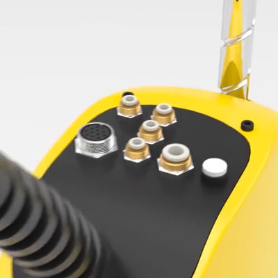

Easy error recovery
Equipped with a brake release switch on its arm, the FANUC SR-6iA/H ensures easy error recovery.

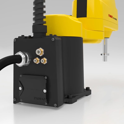

Mounting options
FANUC SCARA robots are available with wall mounting equipment options or a bottom cable exit.
