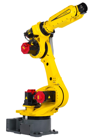

M-800/60-20B
M 800 Laser Cutting
M-800 Series
M-800/60-20B
60 kg
2040 mm
820 kg
The M‑800/60‑20B provides outstanding accuracy and enhanced rigidity, enabling manufacturers to improve the quality of high‑demand processes such as laser cutting, welding and machining—without slowing down production.
M-800iA/60 Laser Scanning Demo
FANUC M‑800iA/60 robot demonstrates laser scanning inspection of metal parts with precise, controlled motion.
M 800ia60 black gb 1
High Precision
Thanks to its highly rigid and robust construction, the M‑800/60‑20B delivers excellent accuracy and performance.
M 800ia60 end effector 1
Absolute Precision Accuracy
The calibration technology FANUC iRCalibration Signature is included as a standard.
M 800ia60 installation interface 1
High Performance
Its excellent motion performance, especially in narrow corners, makes it ideally suited for high‑accuracy path applications such as 3D laser cutting.
