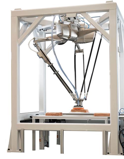

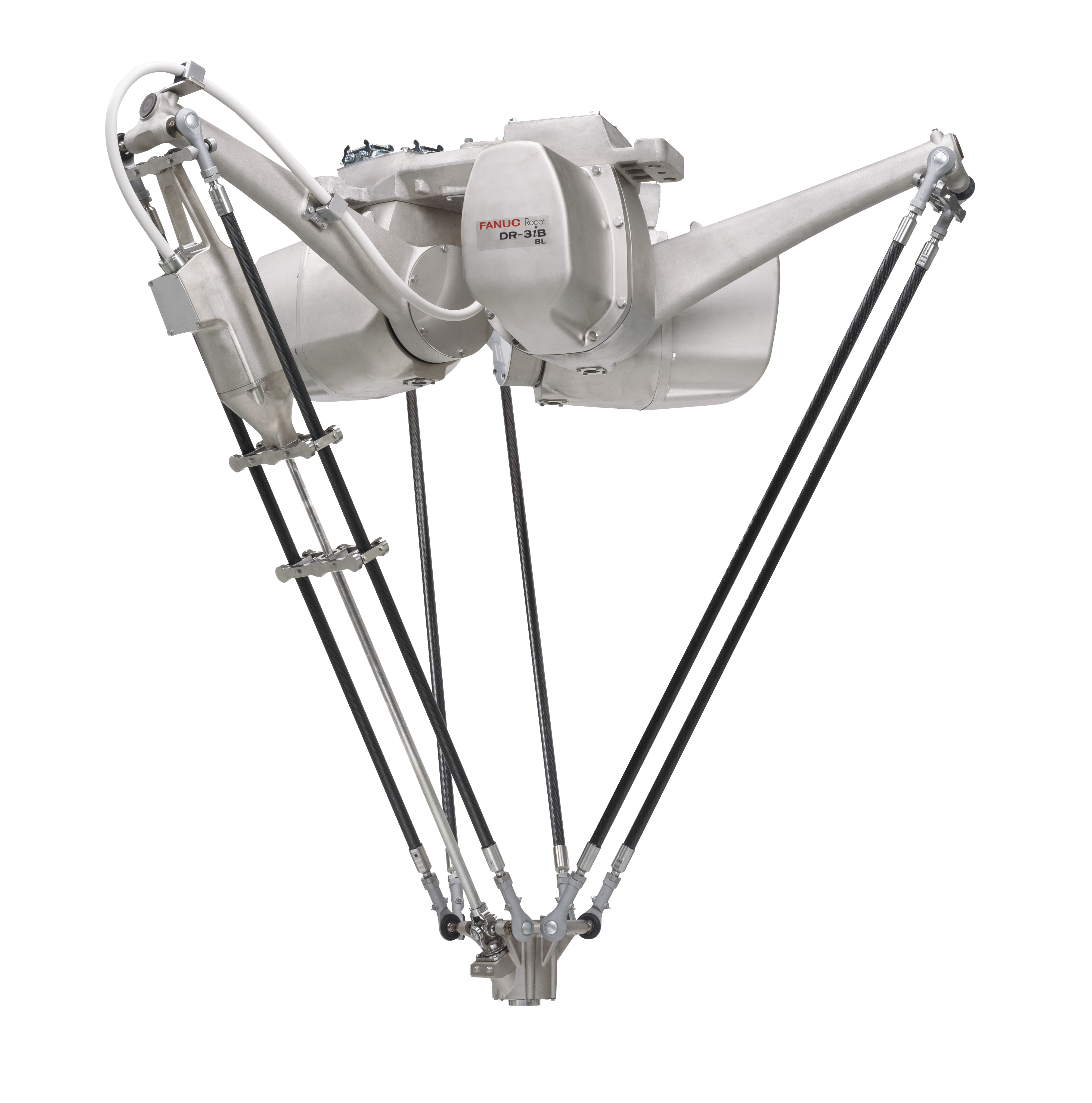

The DR Series is FANUC’s largest-envelope and highest-payload delta robot series. The DR-3iB/6 STAINLESS offers a 1200 mm horizontal reach, 450 mm vertical reach, and 6 kg payload. The DR-3iB/8L offers a 1600 mm horizontal reach, 500 mm vertical reach, and 8 kg payload.
This extended reach and payload capacity make the DR Series well-suited for applications such as wide conveyors and case packing into tall boxes or cartons, while maintaining repeatability of ±0.03 mm. With higher payload capacity and increased wrist inertia of 0.2 kgm², the DR Series can handle heavier products at higher conveyor speeds.

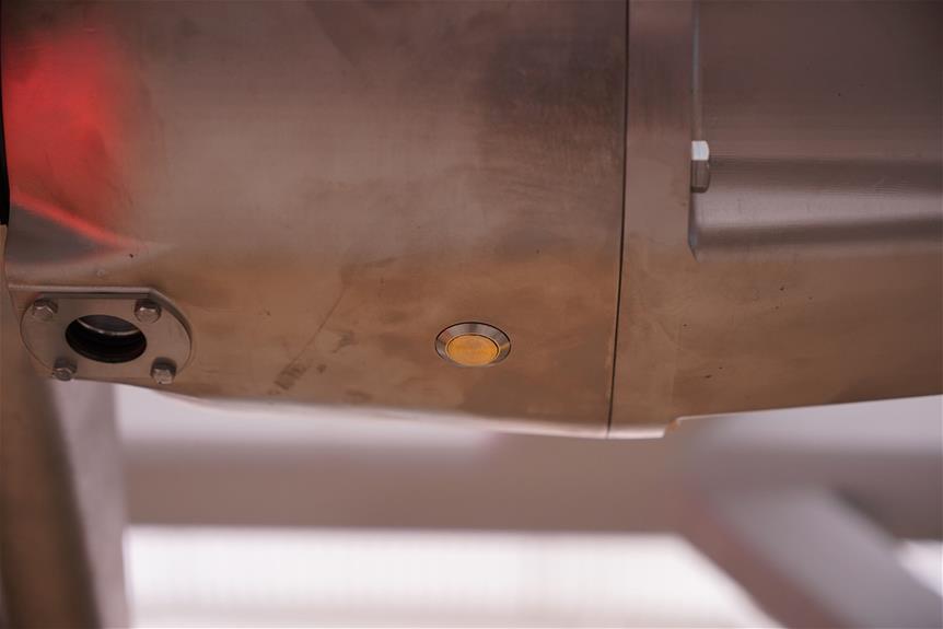

Brake release feature
A brake release switch allows users to conveniently move the robot without the need for a teach pendant.

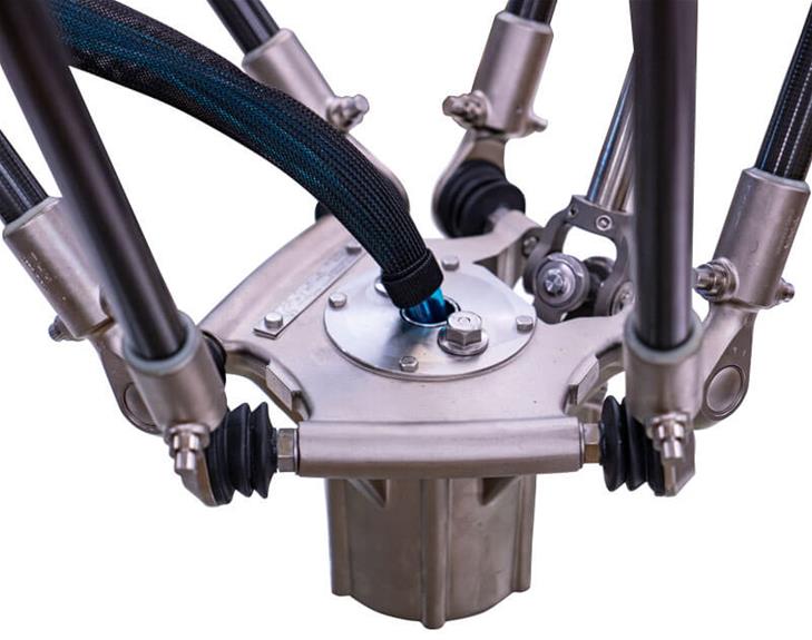

Easy to integrate
The DR Series includes features that simplify cable routing and dress-out. Mounting provisions make it easy to route cables and vacuum hoses along the link arms, while a large 20 mm hollow wrist allows for easier wiring and piping to the wrist and end-of-arm tooling. These features support better cable control and can help extend cable life.

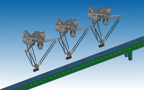

iRPickTool for multi-robot lines
Integrated iRVision with FANUC’s conveyor tracking iRPickTool software makes it easier for multiple high-speed robots to work together efficiently on a production line.

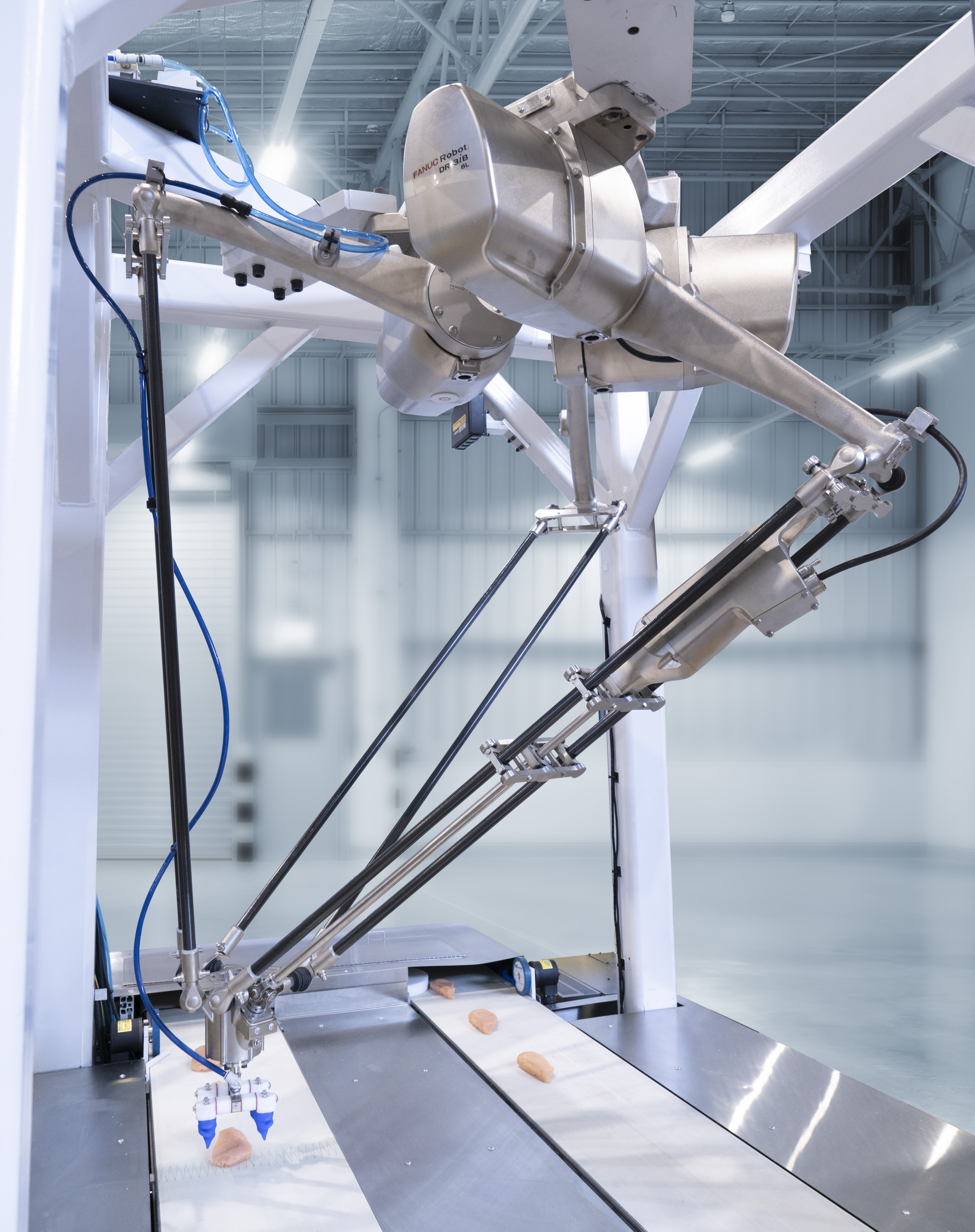

DR 3i B 8 L Picking Raw Chicken

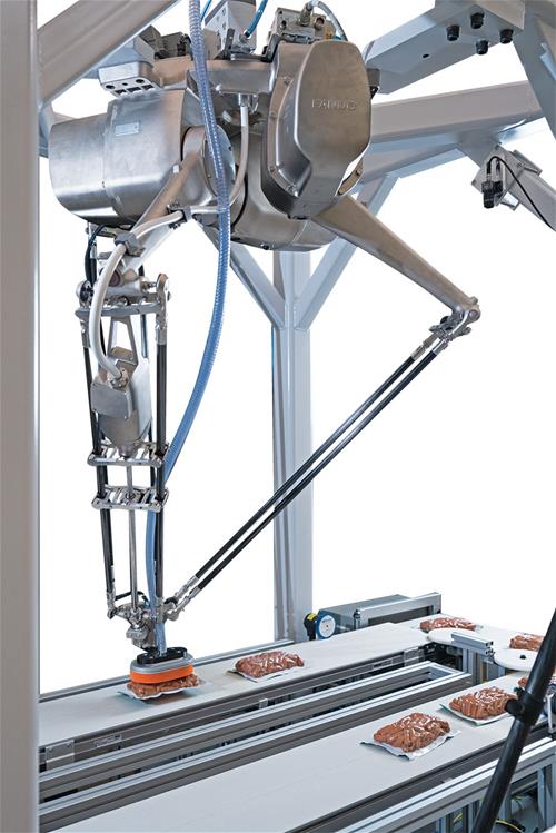

DR Series Delta Robot Applications
FANUC DR Series delta robots are designed for high-speed picking and packing applications, especially in food handling and washdown environments. Built on a proven parallel-link design, the DR Series delivers fast cycle times, increased payload capacity, higher inertia, and the longest reach of any FANUC delta robot at up to 1600 mm.
Common DR Series delta robot applications include:
  • Picking and packing: High-speed product handling for packaging lines, cartons, trays, and cases
  • Food handling: Hygienic automation for primary food products and food-safe production environments
  • Washdown applications: Robotic automation in environments that require frequent cleaning and sanitation
  • Case packing: Handling products across wide conveyors and packing into tall boxes or cartons
  • Conveyor-based automation: Fast, repeatable product picking and transfer on high-speed production lines
DR Series design features make the robots easier to program, clean, and sanitize while supporting strict food safety requirements.

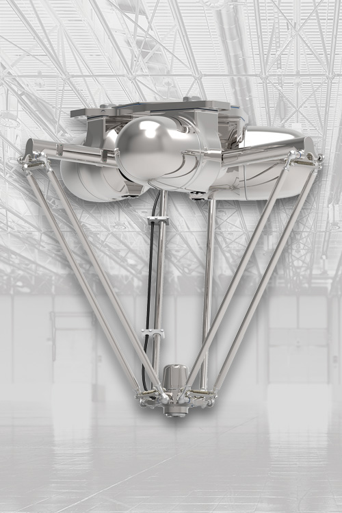

Dr3ib 6 stainless
Stainless Delta Robot
DR-3iB/6 STAINLESS Highlights
More reach and payload for more applications

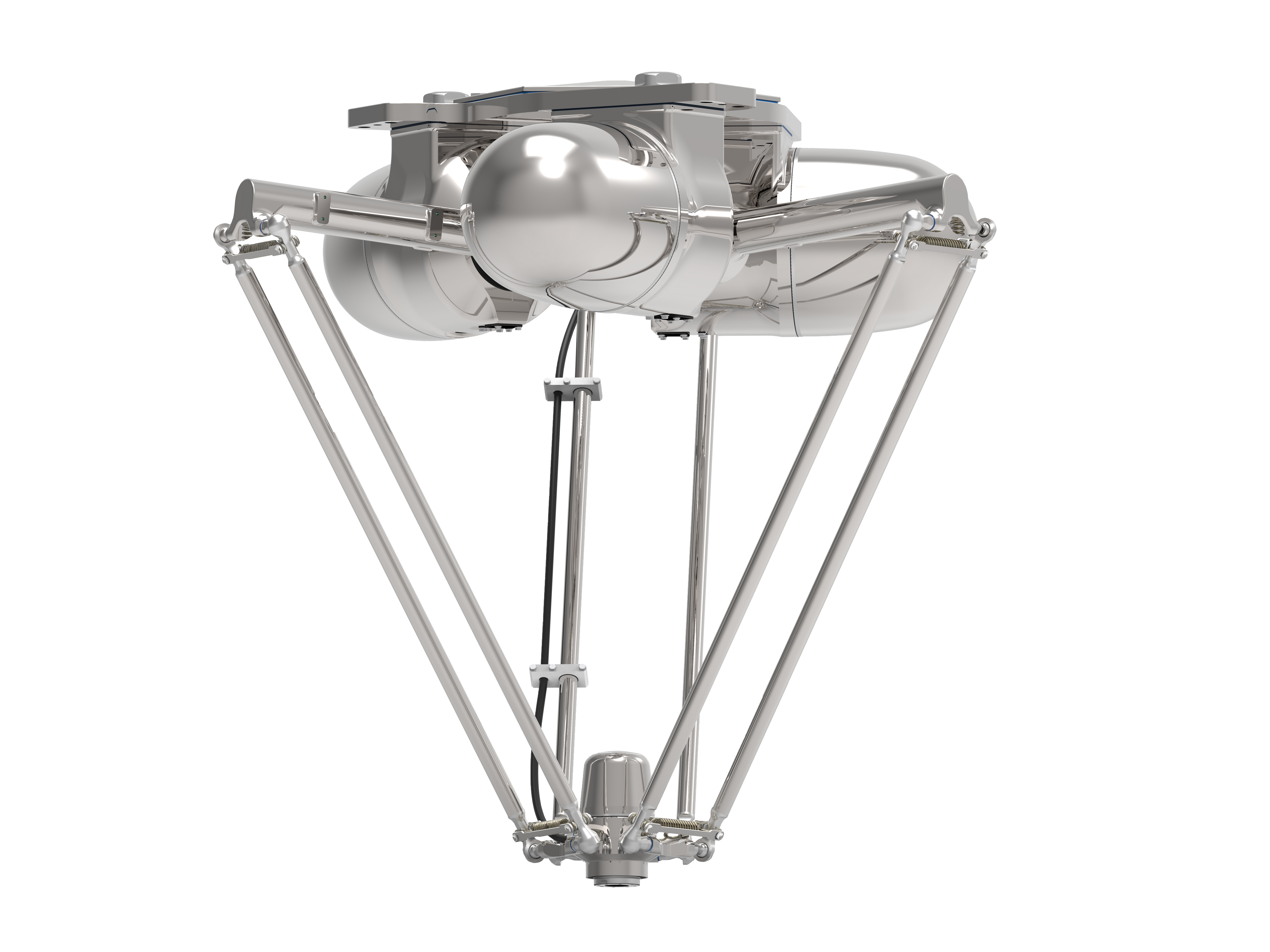

The DR-3iB/6 STAINLESS is FANUC’s first stainless steel food-grade delta robot for picking and packing primary food products. Rated IP69K, the robot meets USDA and FDA food safety standards, and sets a new benchmark for robotic food handling in terms of payload, speed, reach and sanitation.
  • IP69K rated
  • Mirror-like surface finish ensures easy cleaning
  • Resistant to chemicals and high pressure / temperatures required in strict wash-down environments
  • Food safety design with NSF H1 food grade lubricant
