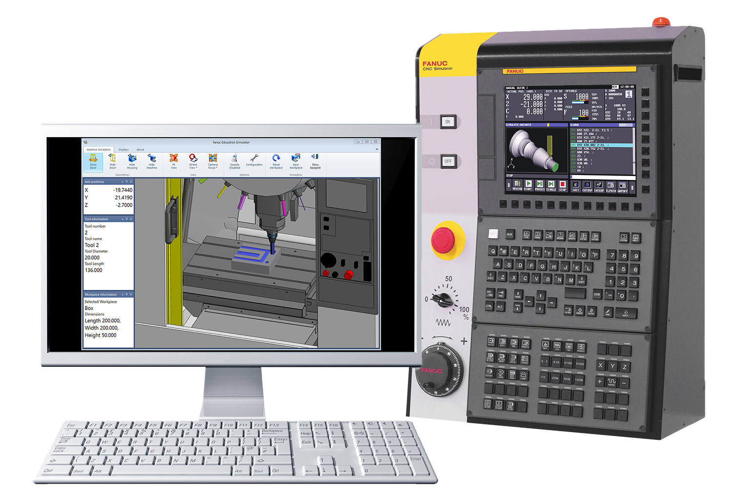

The CNC Machining Simulator builds on the standard simulator by adding an internal PC that powers a virtual mill or lathe with real kinematics. Users can view live machine motion, tooling, and part machining in real time. With required tool and workpiece setup, features like colored backplot, collision detection, and realistic sound create an immersive machining experience. A software-only version is also available for self-install and can connect to the standard CNC simulator via Ethernet.
Features:
  • NC: Oi‐F 3 axis Mill or 2 axis Lathe, switchable at reboot
  • IPC: Pentium Processor N4200 1.1Ghz Quad core, 8GB RAM, 32GB SSD
  • Ports: 4 USB 3.0
  • HDMI display
  • Software included: Windows 11 IoT Enterprise, Machining Simulation, FASBacCNC
  • Brackets
  • User supplies: Monitor, keyboard & mouse

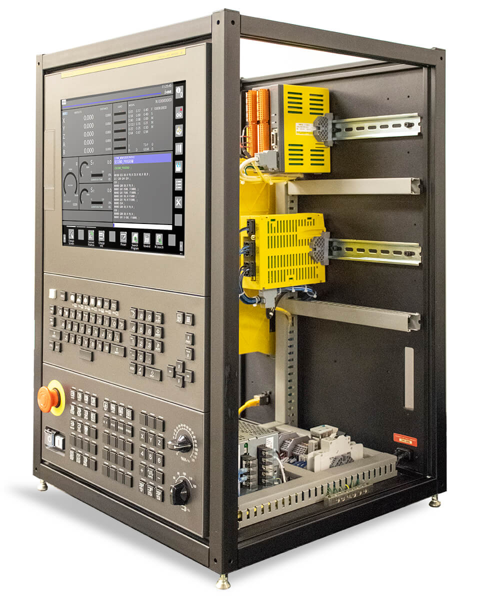

Cnc simulator vertical 15inch
Customizable Options
Think you could benefit from a more customized CNC Simulator solution? Check out our Hardware Simulators. FANUC works with our customers to provide CNC Simulators that combine simulation tools along with our real-world CNC systems and products to give you exactly what you need.
