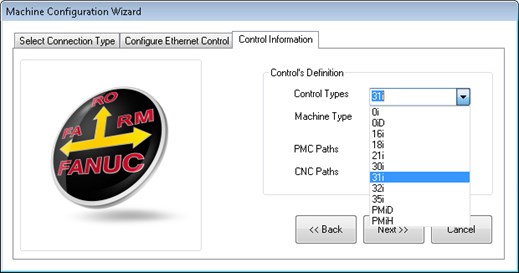

Fasopc config 519x273
Flexible for today’s industry standard
OPC has been an industry standard for years, and many industrial software packages have built-in support for OPC specifically for data retrieval. It makes it easy to move real-time data between factory floor devices (CNCs) and factory monitoring software (HMIs), while assuring the best interoperability with many devices.

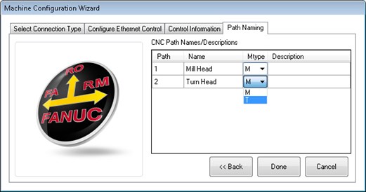

Fasopc config2 521x274
Easy Configuration
The FASOPC configuration utility is an easy-to-use tool to quickly add FANUC CNCs to your FASOPC server. The configuration utility’s intuitive user interface utilizes wizards specifically designed to guide you through the processes of setting up FANUC CNCs. Once a CNC type is identified, then only data relevant to that control type is presented to the user. There is no need for advanced knowledge of FANUC CNC capabilities to use FASOPC.
