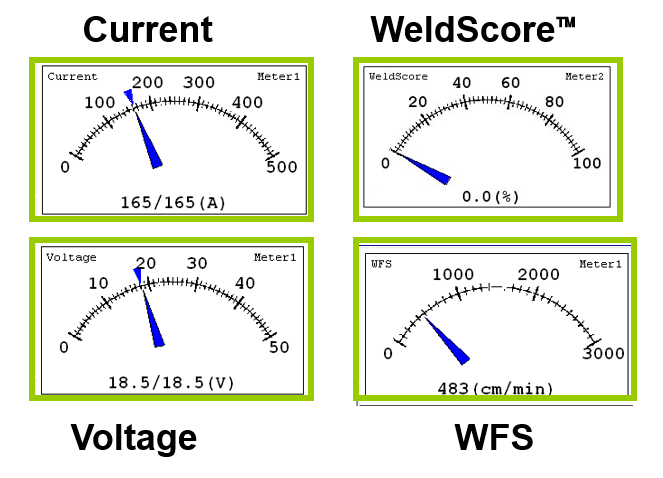

Arc Production Monitor extends a FANUC ArcTool system with built-in connectivity to Lincoln Electric Power Wave® welding power supplies and the CheckPoint™ cloud monitoring platform. When enabled, it allows the robot to exchange weld process data with Lincoln’s Production Monitoring™ system, providing real-time visibility, traceability, and process control for each weld cycle.
This option adds teach pendant control and data integration features, including weld profile selection and part serial number assignment. It also supports error handling, allowing the robot to respond when weld parameters exceed defined limits (such as voltage, current, or wire feed speed), helping flag process issues as they occur.
This feature helps the robot controller become a more integral part of the welding process control system  - simplifying setup, improving visibility into weld performance, and enabling data-driven process optimization.
