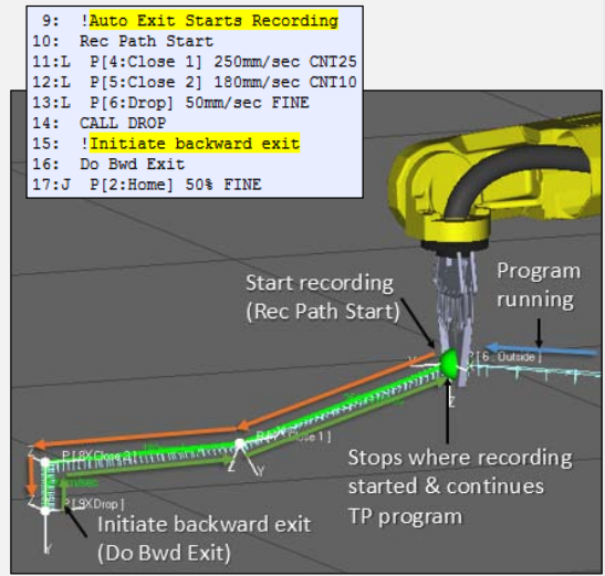

Auto Backward Exit allows the robot to move backwards while retracing its motion path after a fault has occurred. This simplifies getting the robot out of tight spaces after a fault has occurred that requires inspection of the robot, tool, or part.  All this can occur without manual intervention and jogging.
