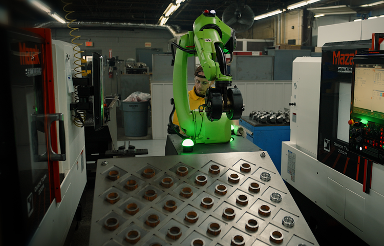

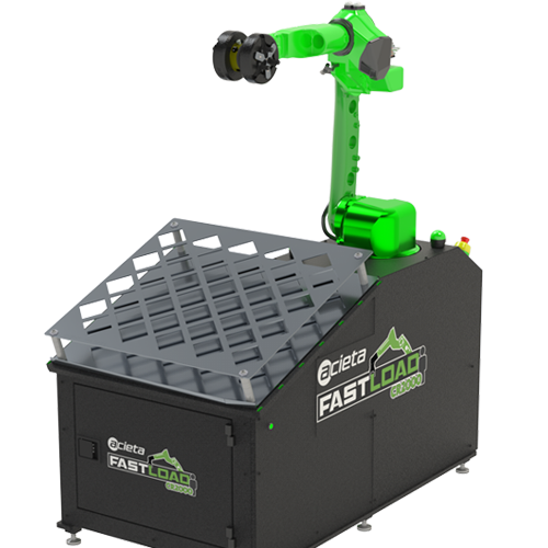

Acieta FastLOAD® CR2000
The CR2000 from Acieta is designed to simplify the automation process with its intuitive touchscreen HMI, enabling quick part setup and parametric programming without the need for prior programming experience. This versatile system can tend to two machines simultaneously, enhancing productivity. It offers standard grid plate options to accommodate various part sizes and is available in 2 and 3-jaw EOAT configurations, which include adjustable finger sets and an air blow-off feature. Additionally, the collaborative robot allows for safe human intervention during operation, making it a user-friendly and efficient solution for various manufacturing needs.
Overall Length
1791.1 mm (70.52 in)
Overall Width
1035 mm (40.75 in)
System Weight
1040 kg (2293 lbs)
Min Part Height
20 mm (0.79 in)
Max Part Height
250 mm (9.84 in)
Min Part Diameter or Width
16 mm (0.63 in)
Max Part Diameter or Width
144 mm (5.67 in)
Gripper Options
Two jaw gripper for square parts or three jaw gripper for round parts
Throughput
Variable
Power Requirements
480 VAC at 3KVA
End of Arm Tooling Type(s)
2 Jaw Back to Back
3 Jaw Back to Back
3 Jaw Offset
Software
Guided HMI
Safety
Area scanners and radar scanners are optional
Compliant Machine Types and Brands
No additional hardware required for all machines with ethernet IP robot interface.
Discreet I/O interfaces are available for most CNC equipment manufacturers
Compatible Robots
CRX-30iA
Collaborative
CRX-30iA
30 kg
1889 mm
View CRX-30iA
