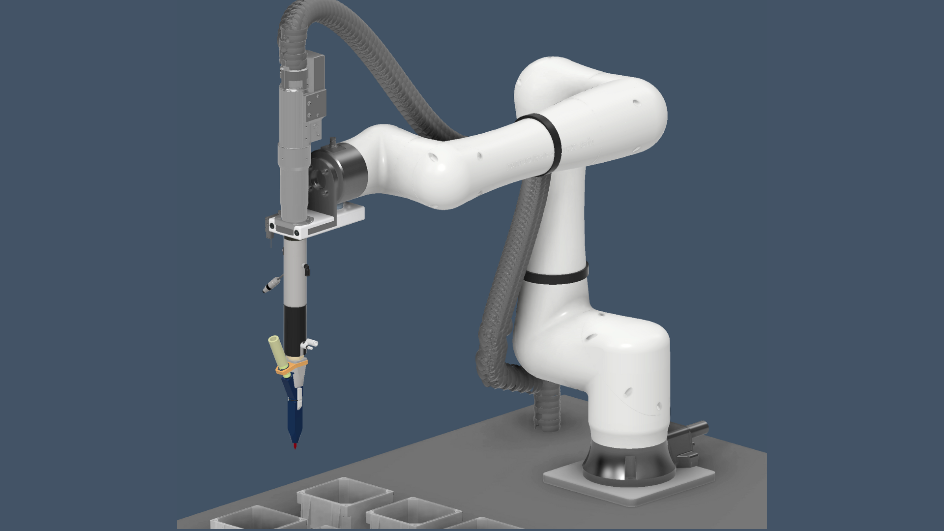

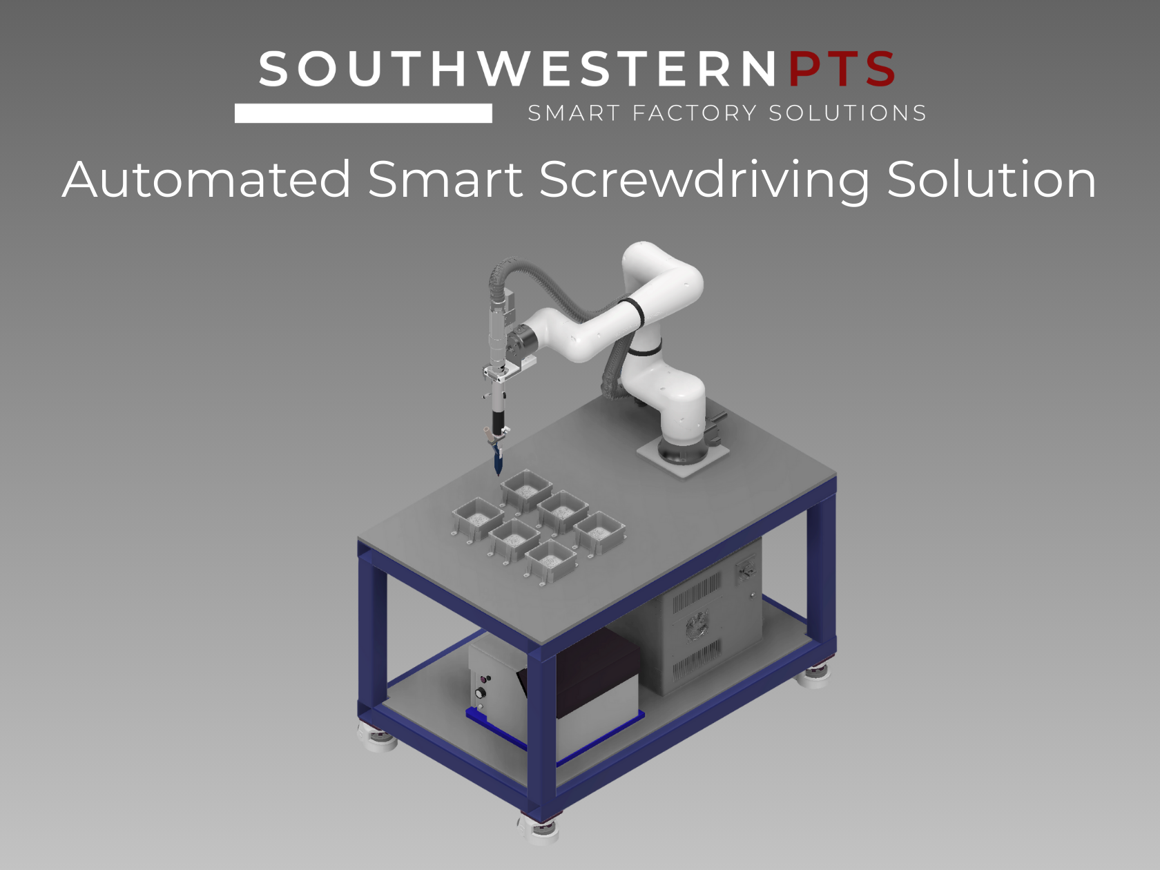

Southwestern PTS’ Automated Smart Screwdriving Solution increases throughput, improves quality, and records data for your fastening process. The cell pairs FANUC CRX cobots with ESTIC transducerized tools, renowned for their precision and full traceability, and is seamlessly integrated by Southwestern PTS using our fastening expertise. Configurable for a wide range of torque and reach needs, it adapts to any assembly on your production line.

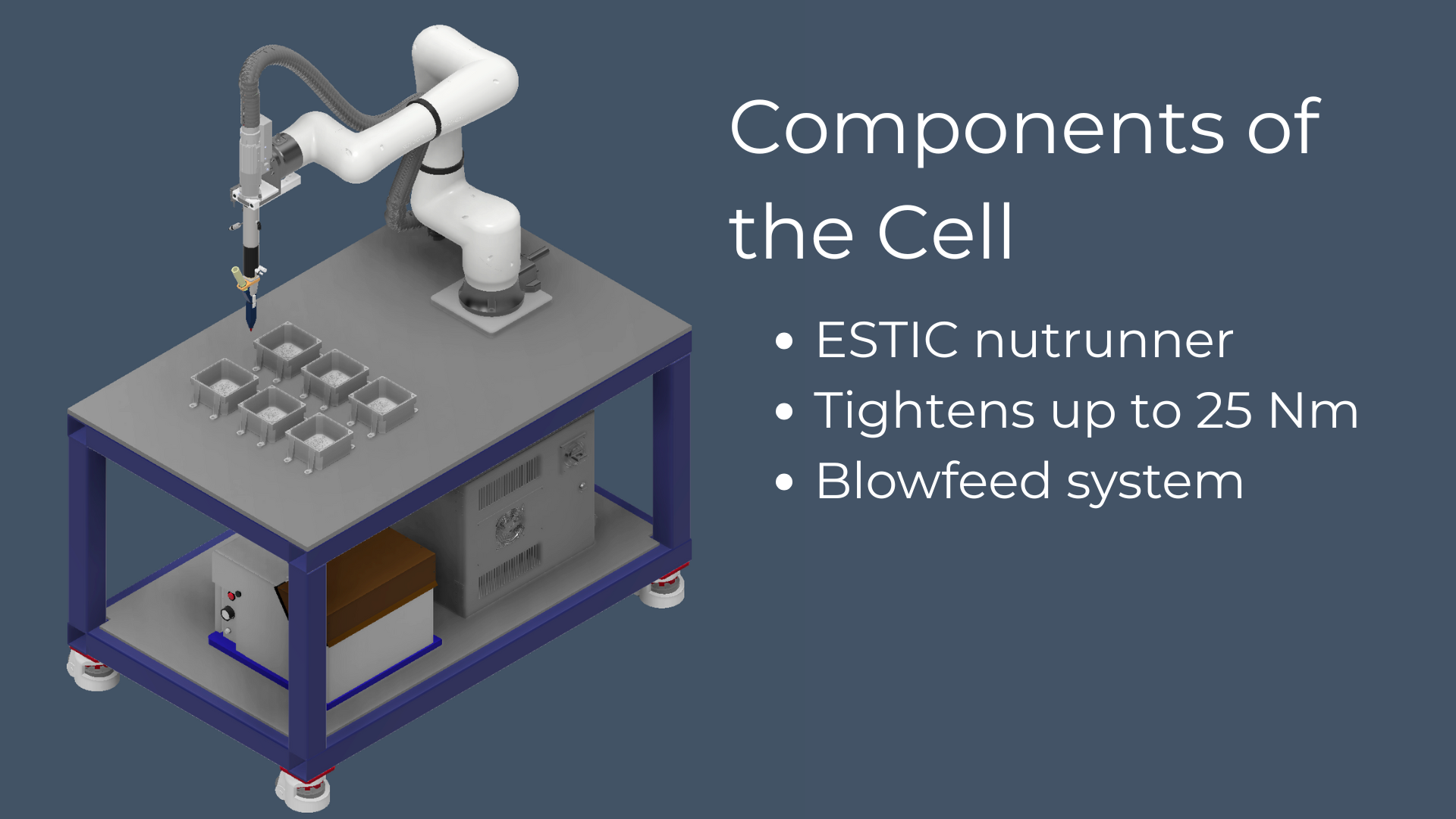

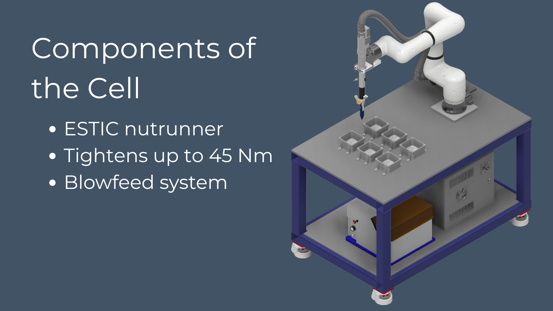

  • Broad fastening capability: A torque window of .1–140 Nm allows one setup to cover a wide span of fastener sizes without swapping tools.

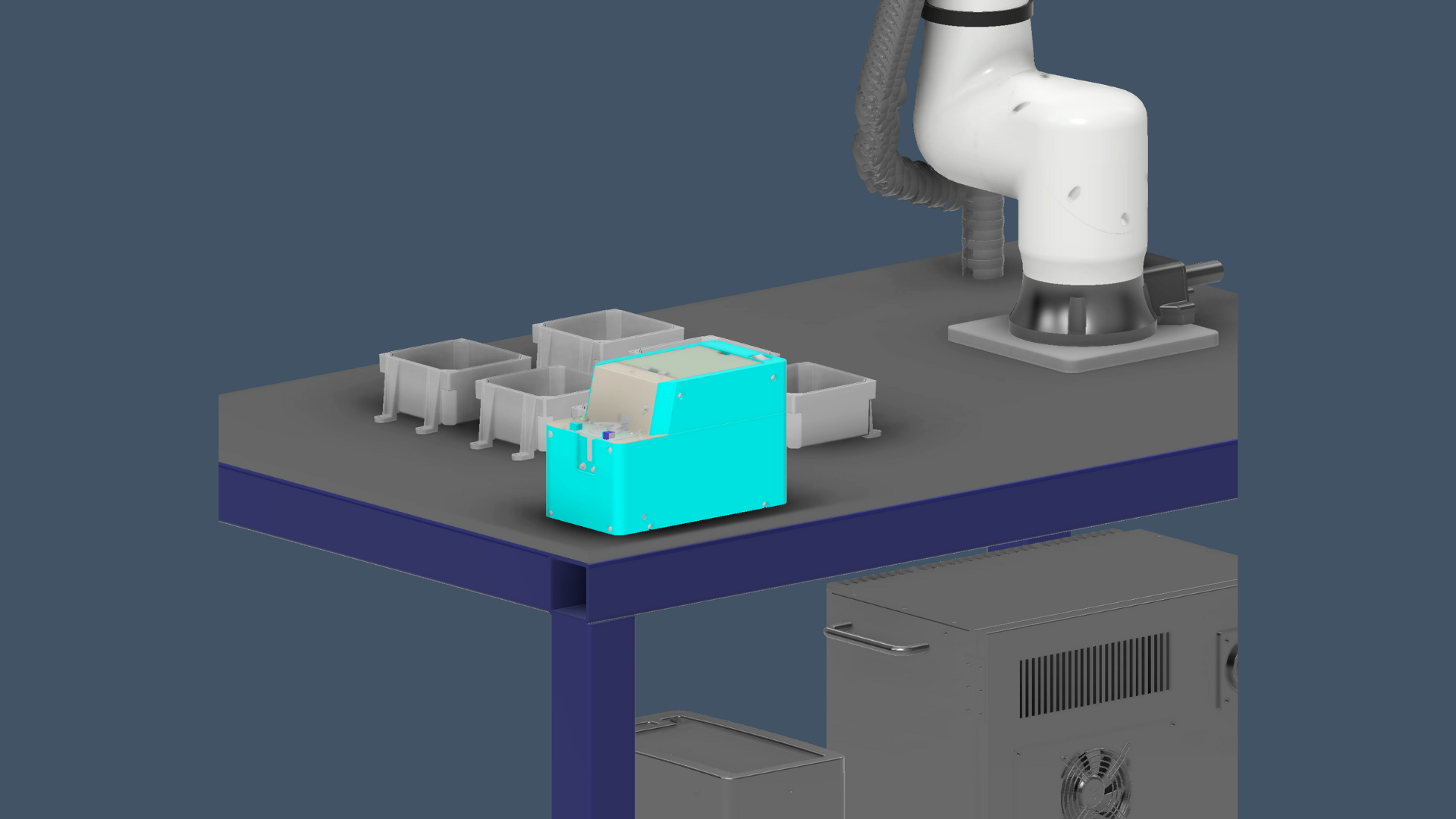

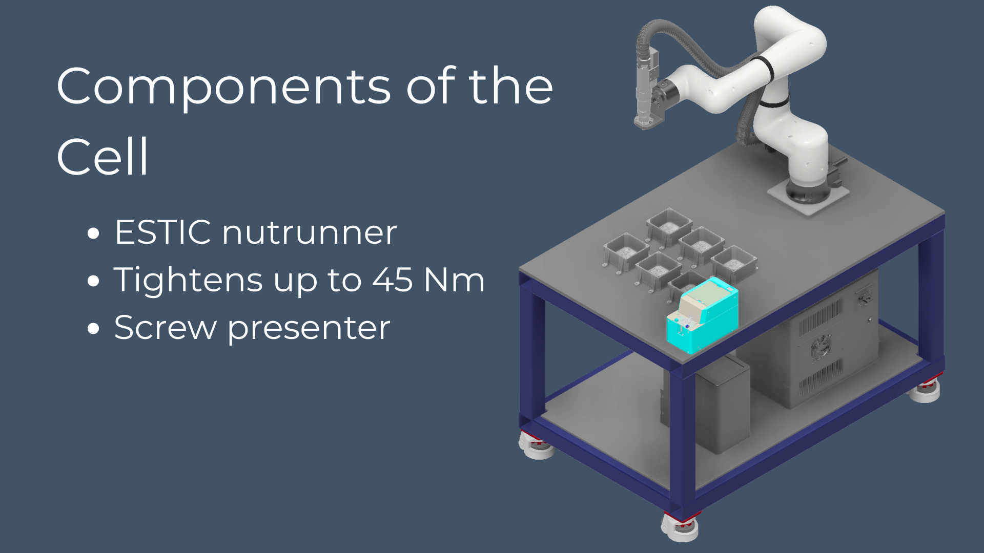

  • Stable, automated fastener delivery: The bowl feeder option maintains a steady supply of screws, supporting consistent cycle times and reducing operator intervention.
Throughput: cycle time is 3-4 seconds per screw position when using the pick and drive system and 1 second when using the blow-feed system.

The EOAT is a mounted Estic transducerized pulse tool, the model of which is chosen based on the torque needed, covering a torque range of 0.1N・m (0.88 in.lbs) to 140 N・m (103 ft.lbs)
