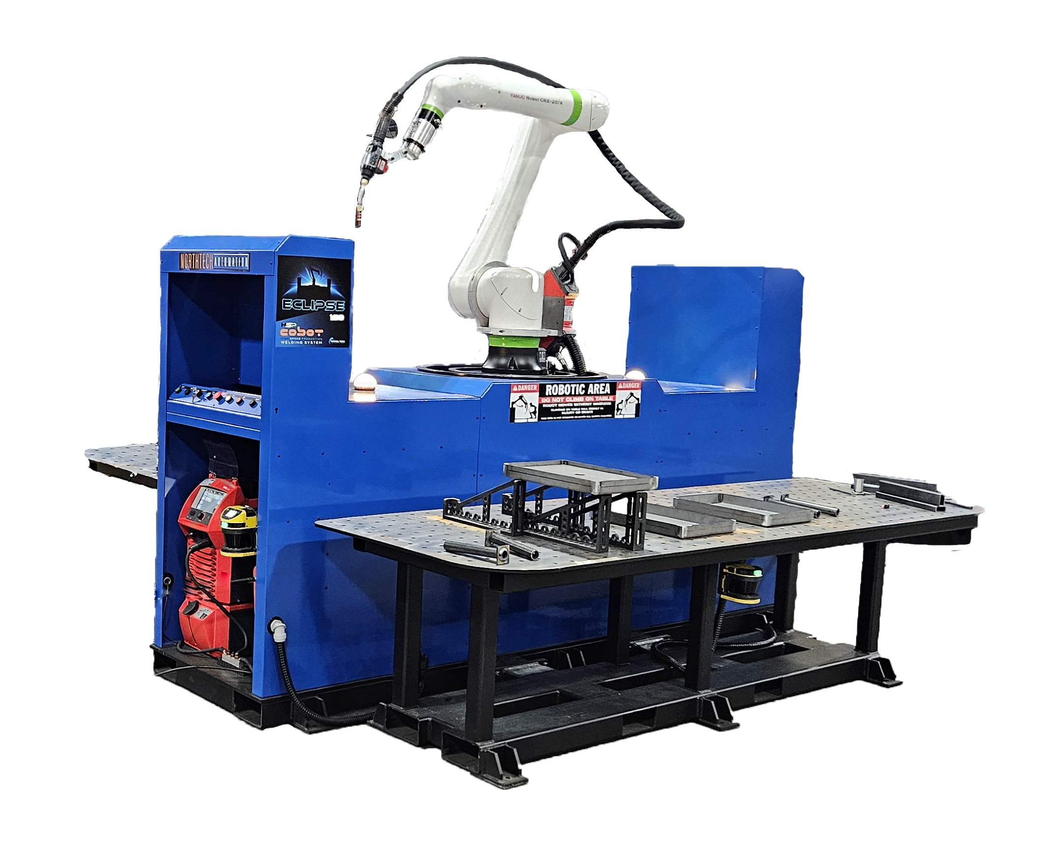

Eclipse 120 Robotic Welding System
Northtech's Dual Station Cobot Welding System featuring Tooling Tables that work with standard welding fixture kits.
Revolutionize your welding productivity with the Dual Station Cobot Welding System — engineered for speed, efficiency, and unmatched ease of use. Featuring a spacious 120” x 40” work envelope and dual operator stations, this system keeps your workflow moving while delivering premium weld quality.
Whether you're scaling up production or streamlining small-batch workflows, the Eclipse 120 is built to deliver — fast, flexible, and future-ready.
Features
Solution Features
Features
  • Long-Reach CRX 30iA FANUC Collaborative Robot
  • Motion Speeds 8X Faster Than Competitive Cobots
  • Standard System Includes OTC 400 Amp Digital Pulse Robotic Welding Package
  • Quick Job Set Up That Justifies Automated Process
  • Two 120" X 40" Operator Stations
Why Choose Eclipse 120 Robotic Welding System?
Through Northtech's extensive experience and R & D, our machines are smooth and problem free. Even with complex welding torch angles.
  •    Up to 8X Faster: Outpaces traditional cobots with fast motion speeds
  •   150% More Efficient: Boost output over manual welding with consistent, high-quality results
  •   Rapid Job Setup: Spend less time programming and more time welding — ideal for high-mix, low-volume environments
  •  User-Friendly Control: Program and operate the FANUC CRX-30iA cobot easily via Android tablet
  •  Powerful Performance: Equipped with the OTC Daihen P402 400 Amp pulse welding package for precision and reliability
  •   Seamless Workflow: Dual stations allow one side to be prepped while the other is welding
  •  Smart Cable Management: Stay safe and organized with the Northtech TunnelTek cable management system
Enhance Your System with Optional Upgrades:
  • Water-cooled torch for high-duty cycle applications
  • Head and Tail Stock Part Positioners
  • Automatic nozzle cleaning station for minimal downtime
  • Upgrade to a 500 Amp welding power source
  • Intelligent software tools: Low spatter, seam tracking, stitch welding, touch sensing, and multi-pass welding
