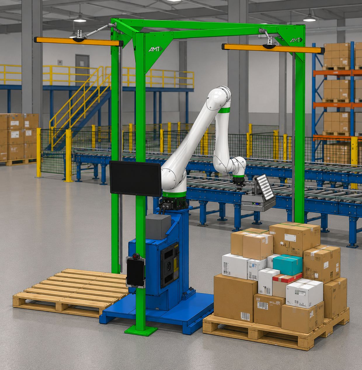

The Maverick Depal from AMT is a collaborative depalletizing cell designed to automate mixed‑SKU case depalletizing with speed, accuracy, and minimal operator intervention. Powered by a FANUC CRX‑30iA collaborative robot and integrated AI vision, Maverick Depal identifies, picks, and transfers mixed cases from inbound pallets in real time—no pre‑sorted pallets required.
This solution is purpose‑built for manufacturers dealing with variable case sizes, graphics, and orientations, where traditional fixed automation falls apart and manual labor becomes a bottleneck.
Features
Solution Features
How It Works
  • Mixed SKU pallets are placed into the depalletizing cell.
  • Integrated 3D camera vision scans the full pallet and identifies visible cases.
  • The AI vision system determines the next best case to pick in real time.
  • The FANUC CRX‑30iA is sent precise pick coordinates.
  • The robot aligns the vacuum EOAT, attaches to the case, and lifts it from the pallet.
  • The case is transferred to the designated drop‑off location.
  • The process repeats until the pallet is empty.
  • FANUC CRX‑30iA Collaborative Robot
    Safe, flexible cobot designed to work alongside people with simplified deployment.
  • AI‑Driven Mixed Case Vision
    Mujin vision system identifies cases by size, graphics, and orientation.
  • Vacuum Case Gripper EOAT
    Reliable top‑pick solution for consistent box handling.
  • Integrated HMI
    Operator interface for control and system monitoring.
  • AMT Maverick Portable Base
    Designed for practical factory deployment and repositioning.
  • Dual Depallet Locations
    Supports efficient pallet handling and workflow optimization.
Software & Controls
  • Mujin Controller
  • FANUC R‑30iB Plus Mini Controller
  • AI box locating
  • 2D & 3D vision guidance
  • Advanced collaborative robot functionality
