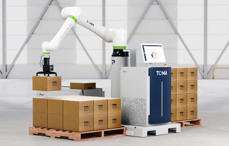

TOMA Palletizer (PAL-0830-N)

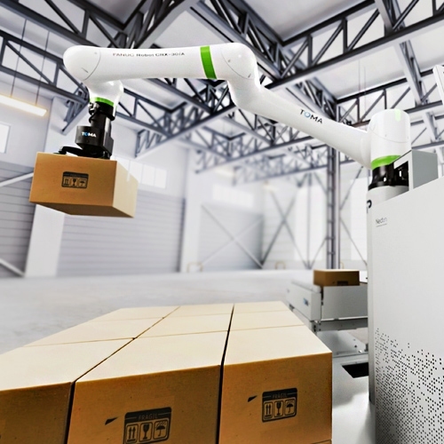

TOMA, developed by Premier Tech, represents a significant advancement in industrial automation by combining user-friendliness with robust performance. Born from decades of expertise in packaging and robotics, TOMA aims to make automation accessible to businesses of all sizes. The TOMA palletizer, for instance, is designed to be easy to use and safe, featuring a fully integrated conveyor and changeable gripper to handle a variety of products. This flexibility allows businesses to boost productivity and stay competitive in highly mechanized markets.

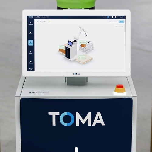

One of the standout features of TOMA is its proprietary software, MOVN, which enables users to configure and operate the system without needing extensive coding knowledge. This software, along with Premier Tech's comprehensive client services, including 24/7 remote technical support and extensive training, ensures that businesses can quickly adapt and optimize their automation processes. The TOMA system is not only efficient but also designed to be quickly deployable, with shorter lead times compared to similar solutions.

Dimensions, Footprint, Reach
113.8'' x 118'' footprint - Can fit pallets of up to 48x48 depending on product characteristics.

End of Arm Tooling
Venturi system. Industrial grade 3D printed suction cup vacuum grippers, foam pad grippers. Clamp/shelf grippers compatible. Pail grippers compatible.
