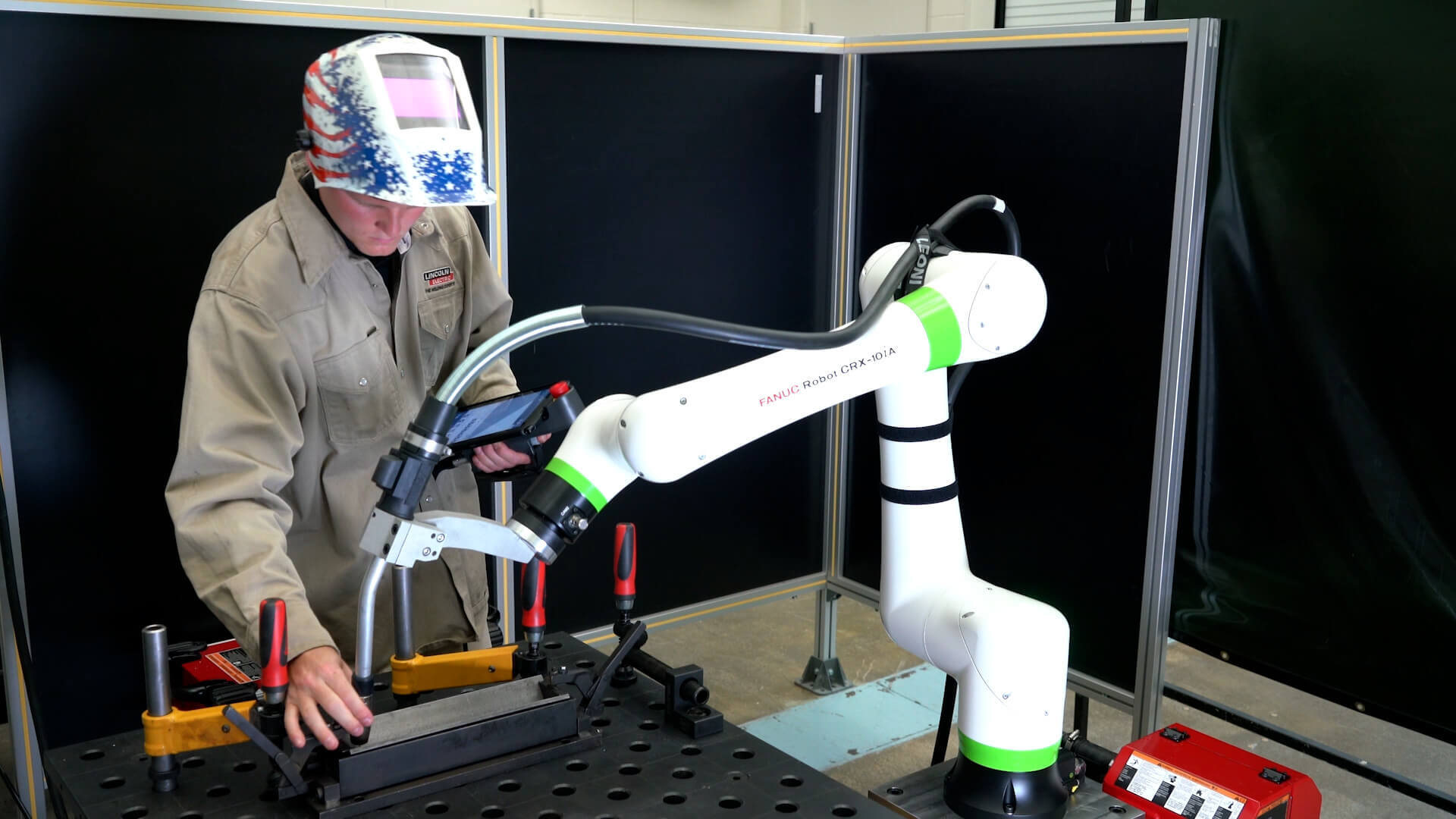

The latest CRX welding cobot is quick to set up and easy for any skill level to operate. The CRX cobot welder can be programmed using a touchscreen tablet while the programmer moves the robot to the desired weld location on the part.
“It’s really a short learning curve to get up and running quickly,” Kowalski says. “This includes the main feature of the CRX cobot, which is the quick teaching of simple welds.  It’s an intuitive process and an operator can learn to perform it almost immediately.  They just position the torch on the part, push a button and that program is created.”
