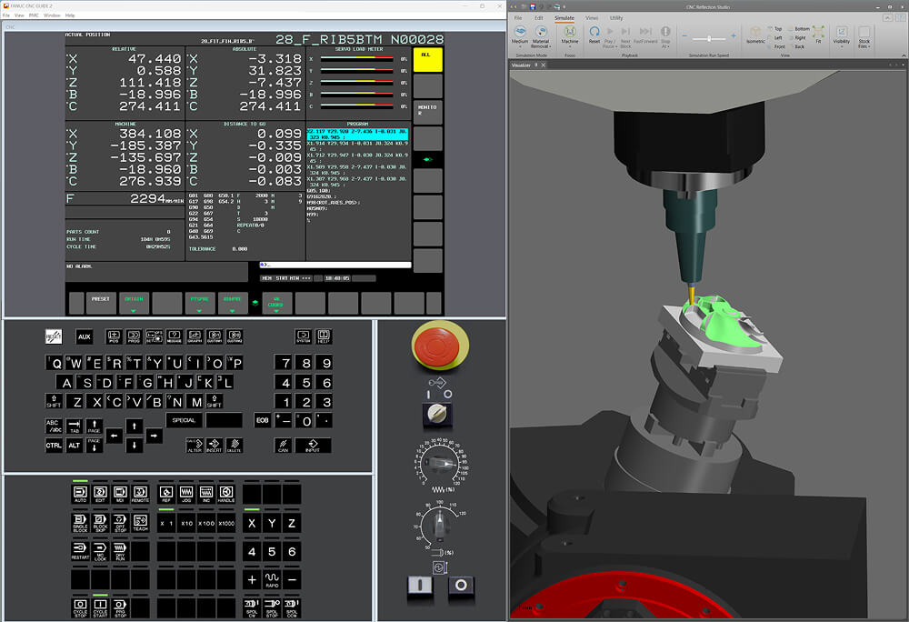

Digital twin software screenshot 1

Additionally, FANUC’s CNC GUIDE 2 and Surface Estimation Tool replicates real-world surface finish results in digital simulations to accurately check not only the part shape, but also machining quality level. Prior to any real-world cutting, the software precisely estimates a part’s machined surface by using the position data of each axis then simulating the cutting to detect machining issues. Knowing this before cutting helps avoid wasting valuable time and materials that otherwise might be produced with marks or other surface defects.
