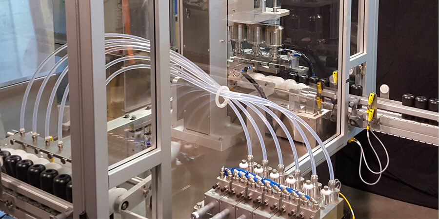

As cases of COVID-19 began to intensify across the U.S., a diagnostics manufacturer reached out to ESS Technologies to build two identical filling systems with automated cap torque for diagnostics vials to be used in manufacturing COVID-19 test kits.  Speed and urgency drove the project, which required the system to fill up to 120 vials/min.
Though originally developed for vials used in COVID testing, the machines can be used for pharmaceutical manufacturing applications using vials or small bottles. Available in semi-automatic and fully automated configurations, ESS’ flexible filler/capper uses a circular puck conveyor system to transport vials or small bottles to the inline filling system. A timing screw drive positions six vials beneath the six-up diving nozzle assembly where a precise amount of diagnostic reagent is dispensed. The cap placement is automated using FANUC’s SR-6iA SCARA robots and a cap feeder. A three-up final torque station then applies the precise amount of torque to the caps. The machine uses Allen Bradley PLC controls and a 6 in. color touchscreen HMI for ease of operation. An optional 10 in. HMI is available. The system provides fast changeover - under 10 minutes.
