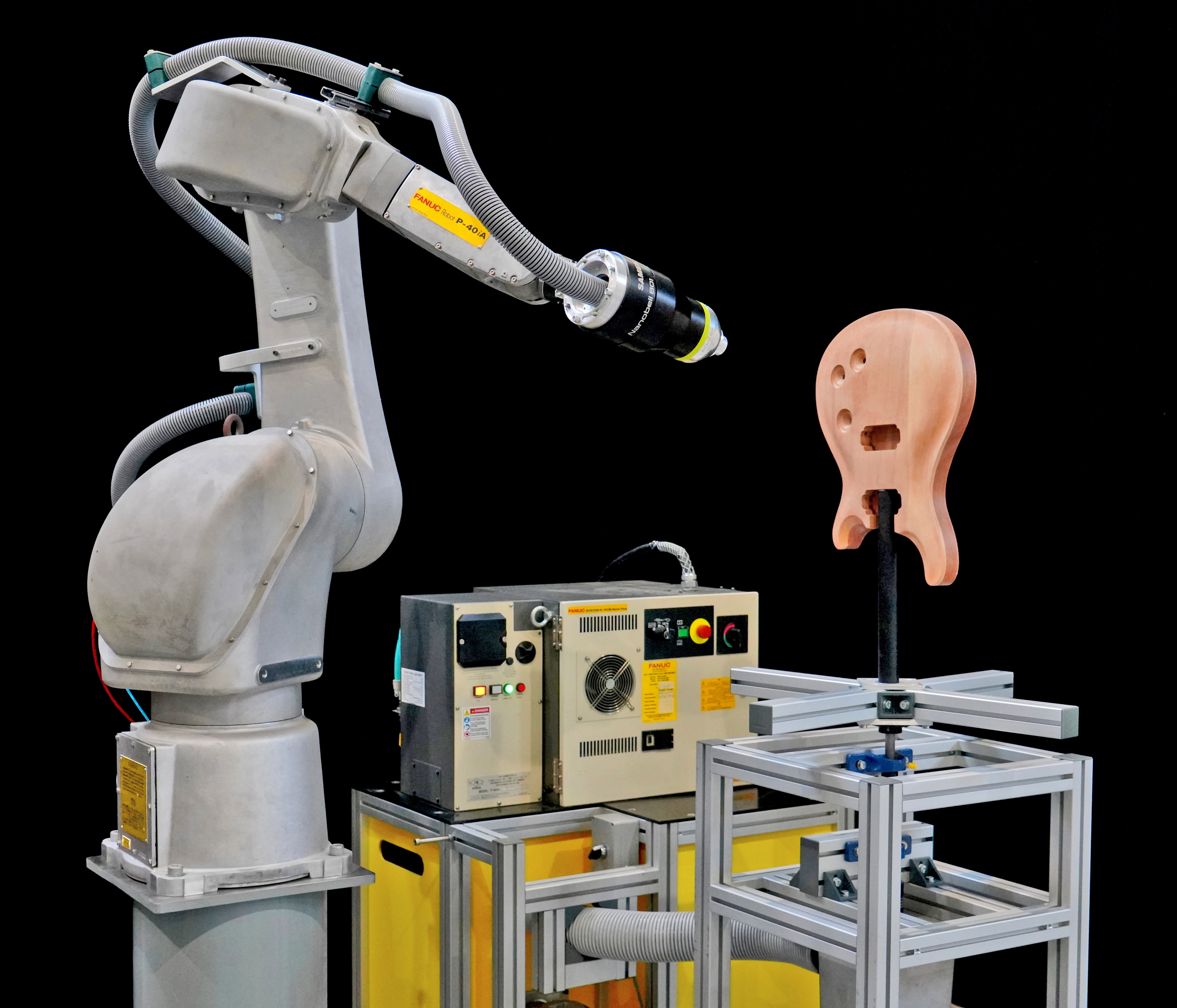

Painting with P-40iA Robot
The FANUC P-40iA is the latest model in its paint robot series, and offers an affordable and versatile solution for companies looking to automate all or part of its painting/coating process.
At IWF, a P-40iA paint robot equipped with the R-30iB Plus Mate controller will demonstrate painting a wooden guitar body using coordinated motion with a turntable, which means that the robot will control the motor that rotates the part on the turntable.  The robot will paint the part as it rotates a full 360 degrees, allowing coverage on all sides of the part.
The six-axis P-40iA is easy to use and extremely flexible to accommodate small lot sizes, new styles and other modifications.   Slim and lightweight, the P-40iA has a 5kg payload, 1300mm reach and excellent 0.03 repeatability.  In addition, the P-40iA can be mounted on the floor, wall, inverted or at an angle which helps companies challenged with small and narrow workspaces.
FANUC America has proudly designed and built all of its painting robots for 40+ years at its corporate headquarters in Rochester Hills, Mich.
