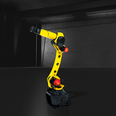

M-10 Series
M-10iD/12
12 kg
1441 mm
145 kg
With its slim design and small footprint, this model saves precious floor space and is ideally suited to compact cells. And thanks to its speed and 5th axis, it makes a great choice on robotic palletizing applications requiring high rates of throughput and maximum reliability.

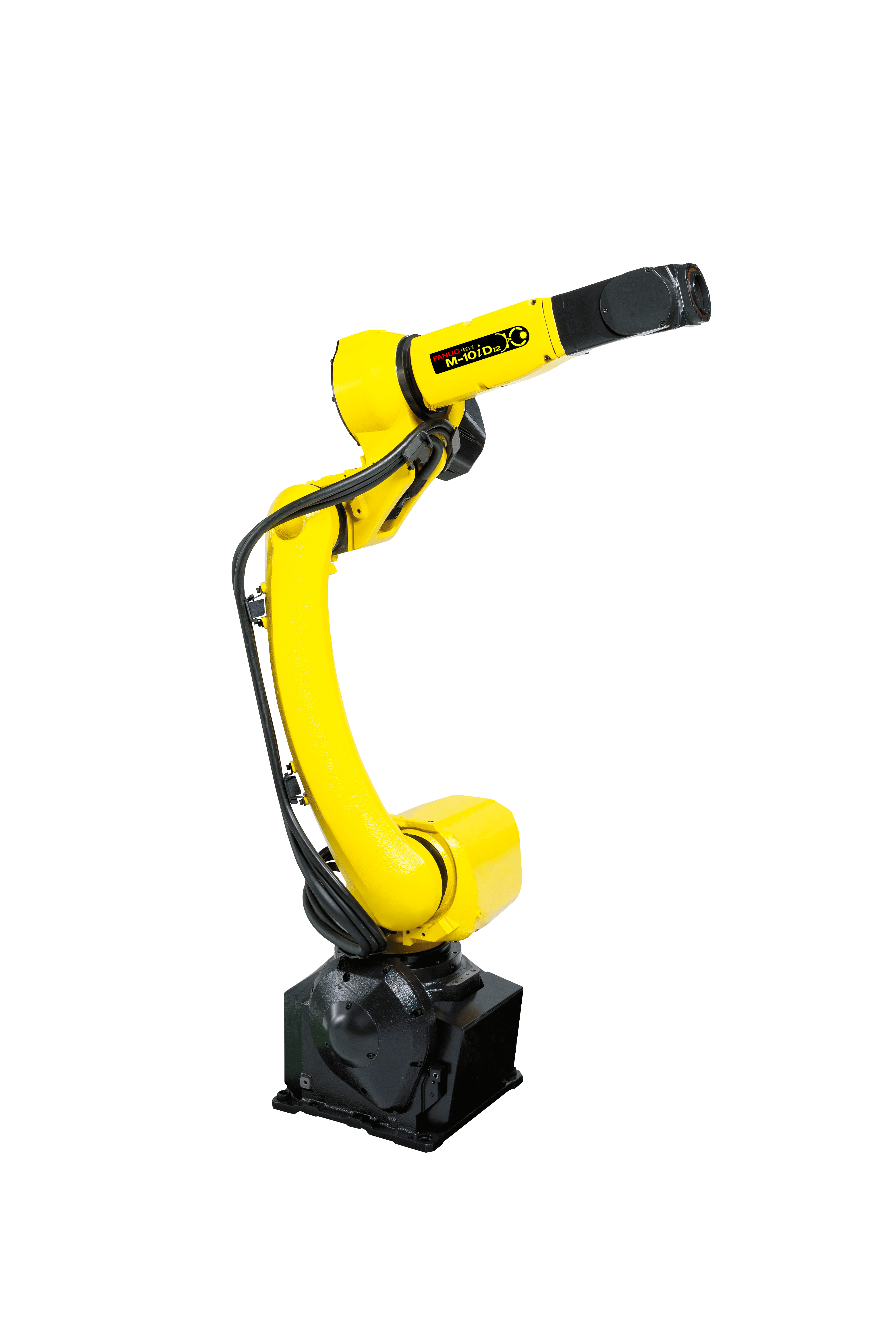

New M-10iD series
M-10iD/12 is the first model of the new M-10iD series, succeeding the well-known and highly rated predecessor M-10iA/12.

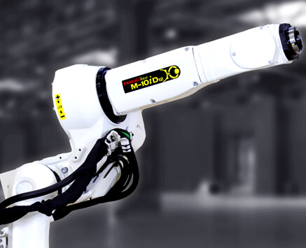

M-10iD/12 Food Grade Option
The M-10iD/12 food grade robot is designed for users in the food industry that need high-speed and high-payload robots.

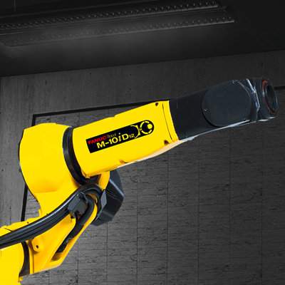

Minimized integration efforts and optimized cable life span
Fully integrated hosepack and cable management design where the cables are lead through the robot’s hollow arm, wrist and body.

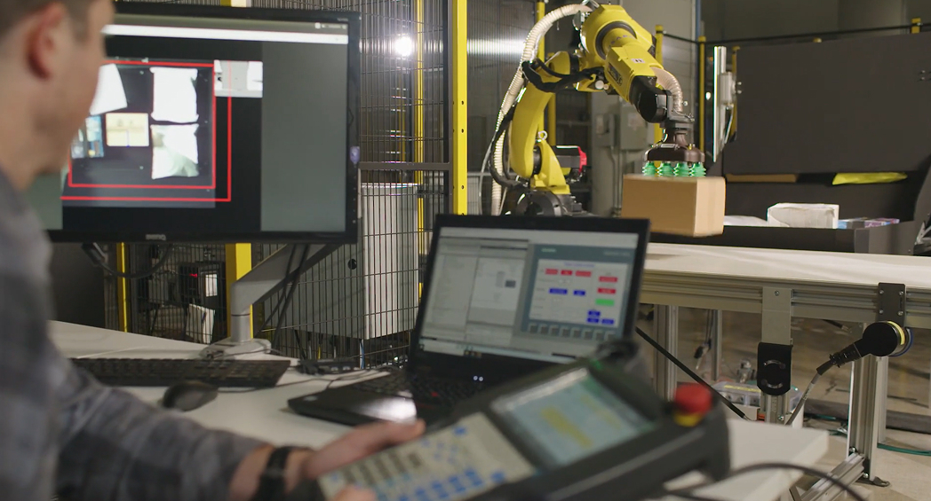

Smart Offline Programming
