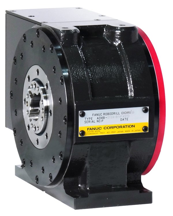

FANUC ROBODRILL DDR H Si B edited
DDR-HSiB
High-speed, high-precision FANUC DDR-HSiB rotary table with seamless CNC integration, superior indexing accuracy, strong clamping, and easy auto setup.

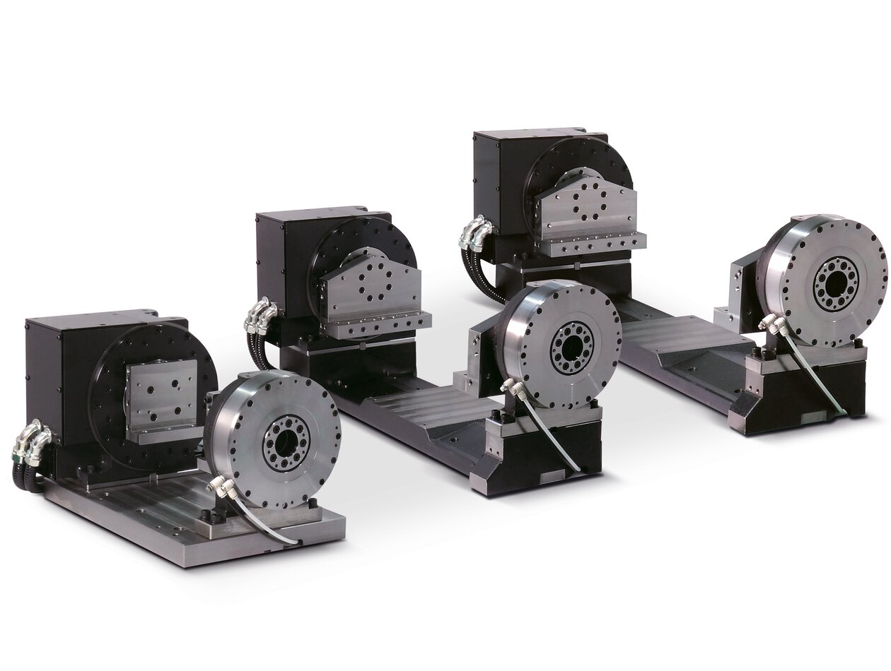

DDR-TiB
Add a DDR‑T trunnion to your ROBODRILL for higher rigidity, precision, and full X‑axis travel — includes spindle support; just add a fixture plate.

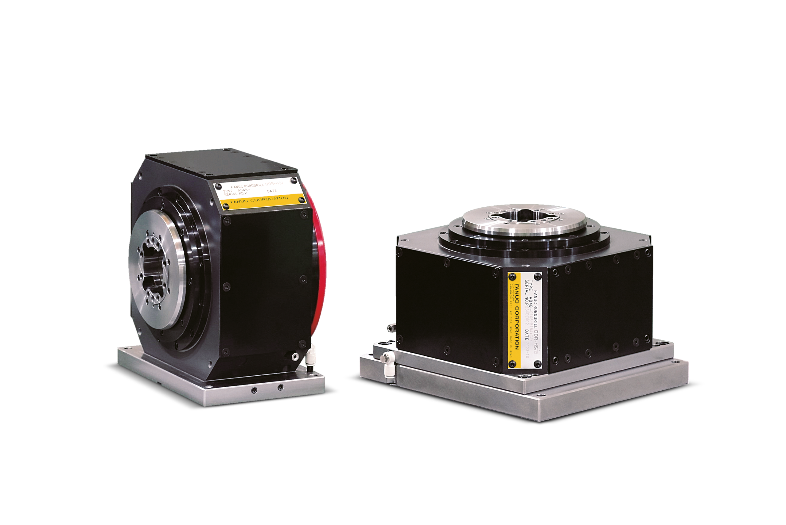

DD Ri B
DDRiB
Direct-drive axis with no backlash, delivering fast indexing, high rigidity, precision, and great value.
