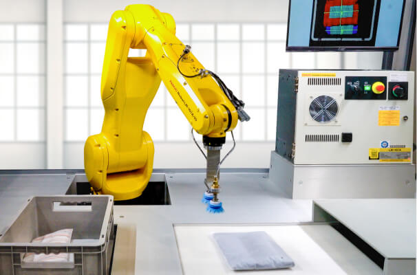

The FANUC LR Mate/10-11A Food/Clean is a compact, fully enclosed 6-axis robot engineered for hygienic environments and high-purity applications. With a 10 kg payload and 1101 mm reach, it delivers exceptional performance in food handling, cleanroom processing, and other contamination-sensitive operations.
Built to withstand rigorous sanitation requirements, the LR Mate/10-11A features an IP67-rated enclosure, NSF H1 food-grade grease, a stainless steel flange, and an FDA/USDA-compliant white coating. It also meets ISO Class 4 cleanroom standards, making it suitable for use in advanced pharmaceutical, medical, and food production settings.
Weighing just 46 kg, this versatile robot can be mounted on the floor, at an angle, or upside down. Its compact, slim-arm design enables easy integration into tight spaces and enclosed equipment, providing manufacturers with the flexibility and efficiency needed to automate repetitive, hygiene-critical tasks.
*Payload can be up to 13kg with restricted envelope.

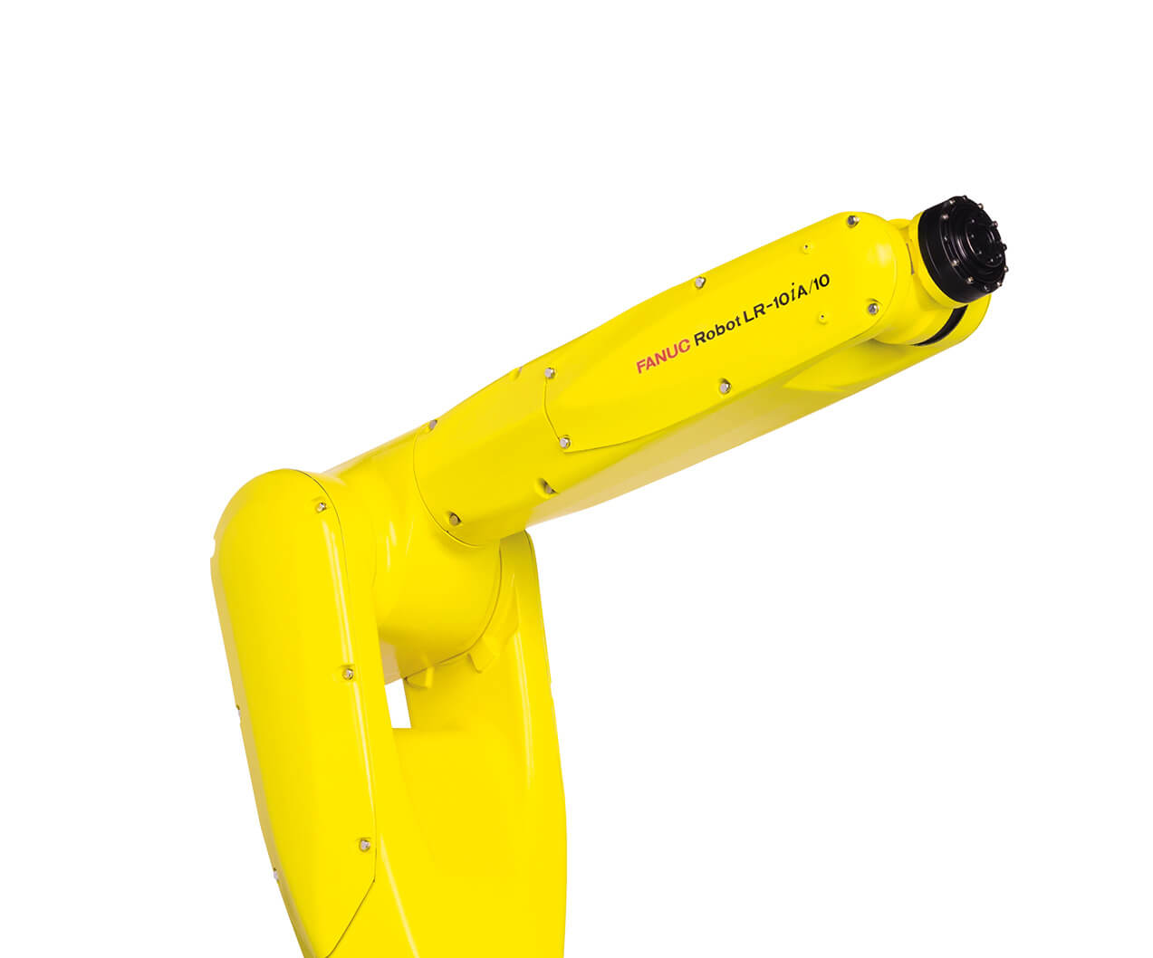

Slim Arm - Narrow Design
The LR-10iA/10's compact design makes for quick, easy, and economical installation for all mounting positions and on AGV’s.
