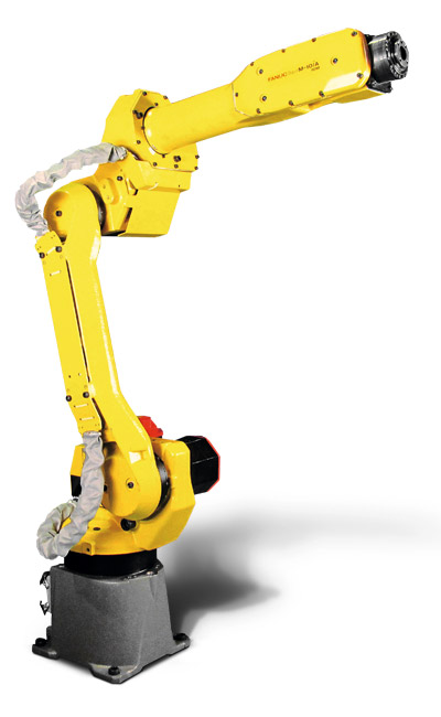

M-10 Series
M-10iA/10M
10 kg
1422 mm
130 kg
With the best payload and inertia in its class, this model delivers improved throughput and optimized cycle times combined with extreme versatility thanks to its 6 axis design. Boasting the highest wrist moments and inertia in its class, this model makes light work of payloads up to 10 kg.
Slim, fast, precise
Weighing only 130 kg, this short arm model offers the best payload in its category and reliable repeatability.
The optimal all-rounder
A cleaner look, better cable protection and durability, easier cleaning and maintenance, better system reliability and improved performance.
