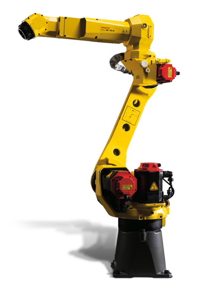

M-10 Series
M-10iA/12
12 kg
1420 mm
130 kg
This model is ideal for higher payloads. Improved protection for jobs involving confined spaces or the risk of snagging is offered by its smart hollow wrist design.
Heavy payload capacity
Ideal for workloads up to 12 kg and envelopes not exceeding 1420 mm.
Versatile, cost effective, hollow wrist design
Hollow wrist and cantilevered J3 arm for best cable protection, easy maintenance and reduced system costs.
Smart Offline Programming
12 kg
Floor / Angle
±0.08 mm
1420 mm
130 kg
340°
445°
380°
380°
230°/s
225°/s
230°/s
430°/s
430°/s
630°/s
